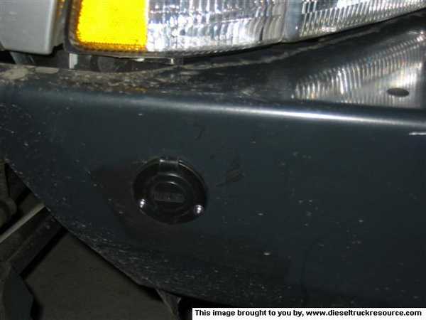

Before I set up this Marinco plug in the bumper, I used to just plug it in and then stuff it back in the foglight hole to keep it protected.
