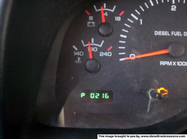

I got this code. Now what? I've been having fuel issues for a while and it all started with the lp giong out. Replaced that, then the truck wouldn't start after being off for more than a couple hours. This started right about the same time my fuel heater started to leak. By now I was using vice grips on the fuel line to keep a prime till morning. Just recently I replaced the check valve on the Vp return line. Had a week or so with good starts (without vice grips) untill this morning. After having the wife crank while I bled injectors, she started right up. I replaced the filter housing with one that does not leak at the heater, added a new filter and bought a hend-held press gauge. At idle I have 14-15 psi after the filter and 12 at 3000rpm. I then bought a code reader and found P0216 sitting there. Is this the end of my Vp or could a seaping fuel heater cause me to lose prime over night?
