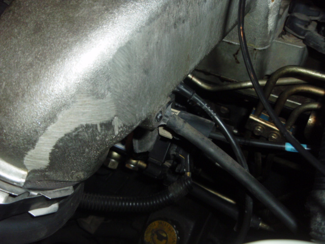

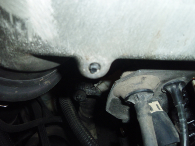

I am checking boost in the driveway, so I'll get on the road. Rigged up a leak tester this afternoon. The lower boots needed to be tightened a little bit. The big discovery was that my wastegate actuator is blown and therefore leaking like crazy. I did find one other spot - there is a hole in the back of the intake air horn. It is drilled into a boss that looks like it is cast in the bottom of the air horn. The hole is plugged with something plastic, but it leaks. Is this hole supposed to be there or is it a present from a prior owner? If this is a factory hole, what is supposed to be in the hole that would keep it from leaking? Thanks!

small sharp screw driver for the clip and you should be making 15 psi minimum .if the waste gate is stuck that will lower boost. also the hole in the intake should not be there .

Weird leaking hole on the air horn
Check out these photos of my air horn. There is a sizeable leak coming from the drilled boss at the bottom/back of the pipe, which is currently plugged with some sort of torn-off piece of plastic. What the heck is supposed to be in that hole ? Do I drill out the plastic junk and hope there are some threads that will accept a proper plug?
