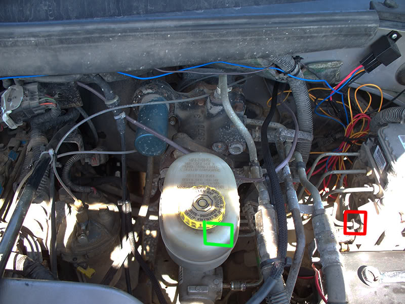

Sorry I wasn't too clear earlier, I'm just trying to get the old girl back on the road.
After I cracked the lines right after the rubber meets the steel and the brakes released, I moved up to around the ABS stuff.
I pumped the brakes up(truck off) until they were locked. Cracked the line at the red square and the brakes released. So I moved to the fitting at the Master Cylinder, the orange square. After opening that fitting a little bit, the brakes would be released. With that being said, I figure that my lines and ABS valving are ok since they brakes would release all the way up to the MC.
Now both front brakes lock on, the rears are fine. I can pump the brakes to lock the fronts, crack the brake line for the rear wheels at the MC and no brake fluid will spurt out. Only the orange square fitting(which I'm guessing is the front brake feed) spurts fluid out.
Could this be only a bad Master Cylinder? I did the "tests" for testing out the Hydroboost and after shut off my pedal is always hard first push. Even sitting overnight the pedal is hard first push. I'm hoping (and thinking) that this isn't an ABS problem, but I could be wrong. Oh and my brake shoes are brand new, got them with my new Calipers. I may order a Master Cylinder and HydroBooster tomorrow just in case it is one or the other
