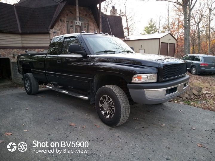

New to the 2nd gen cummins, picked up a 5.9l, 1999, 2500, 5 speed 4w. Now I have my first introduction to issues. Went to take it to the garage for some basic work, truck started OK but would only rev to 1500 rpm. Left it overnight and wouldn't start, pushed into garage and throwing a 606 code which I am told a bad ECM. Also was told another code, 1693 which I am told cold be a bad injector pump. I do have a small fuel leak around filter (after market), hence the garage trip. Could driving with this small leak allow air in and do damage to the injector pump. Any suggestions or insight would be welcomed. Thanks in advance. BTW, no previous issues, was driving for a couple weeks without any issues.New to the 2nd gen cummins, picked up a 5.9l, 1999, 2500, 5 speed 4w. Now I have my first introduction to issues. Went to take it to the garage for some basic work, truck started OK but would only rev to 1500 rpm. Left it overnight and wouldn't start, pushed into garage and throwing a 606 code which I am told a bad ECM. Also was told another code, 1693 which I am told cold be a bad injector pump. I do have a small fuel leak around filter (after market), hence the garage trip. Could driving with this small leak allow air in and do damage to the injector pump. Any suggestions or insight would be welcomed. Thanks in advance. BTW, no previous issues, was driving for a couple weeks without any issues.New to the 2nd gen cummins, picked up a 5.9l, 1999, 2500, 5 speed 4w. Now I have my first introduction to issues. Went to take it to the garage for some basic work, truck started OK but would only rev to 1500 rpm. Left it overnight and wouldn't start, pushed into garage and throwing a 606 code which I am told a bad ECM. Also was told another code, 1693 which I am told cold be a bad injector pump. I do have a small fuel leak around filter (after market), hence the garage trip. Could driving with this small leak allow air in and do damage to the injector pump. Any suggestions or insight would be welcomed. Thanks in advance. BTW, no previous issues, was driving for a couple weeks without any issues.
