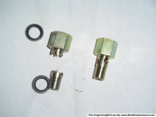

I did that before when I installed the hi-flow banjo bolts. I over torqued the bolt and the head came clean off. I lucked out, and was able to spin the body of the bolt out. Without a head on the bolt, and with clean threads, they spin easily.
This was my blunder :
