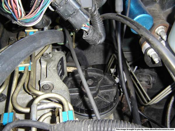

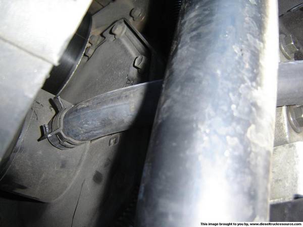

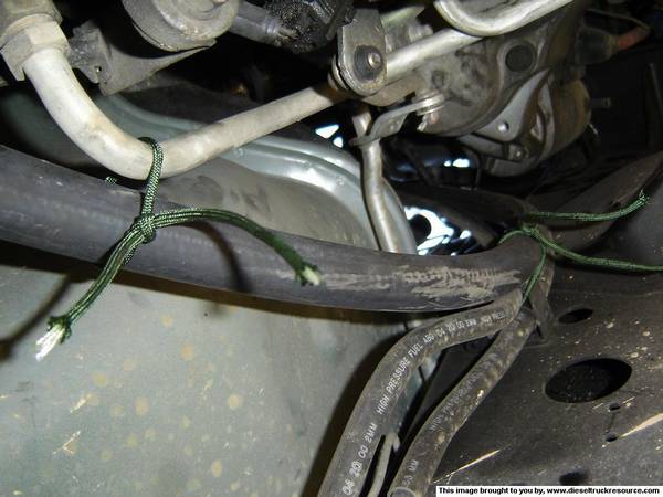

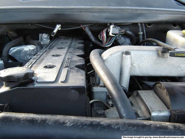

Mine goes from the vent :
Over the top of the engine:
Starts going downward behind the fuel filter housing :
Comes down and runs with the fuel lines:
The rope was replaced with zip ties.
Hmmm. I don't have the picture of the bottle in my gallery anymore, but the hose ends at the transmission cross member, where the bottle is mounted.

Do you still have the parachute cord ? Or did you change to zip ties?
It has been changed to zip ties. I just never updated the pictures.
