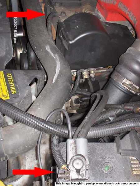

I just fixed mine this weekend, I what i did was very simple, I used the bolt on top on the APPS housing and wired it to the negative terminal on the driver side. I will have a pic soon in my gallery.

here's the pic,
all I did was connect a wire from the top of the APPS housing to the neg on the drivers side battery, I just added split loom to dress it up
