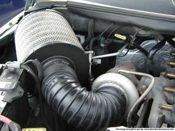

Here's a photo from when I ran a BHAF. Worked well for me until I bought a Scotty Air II.
