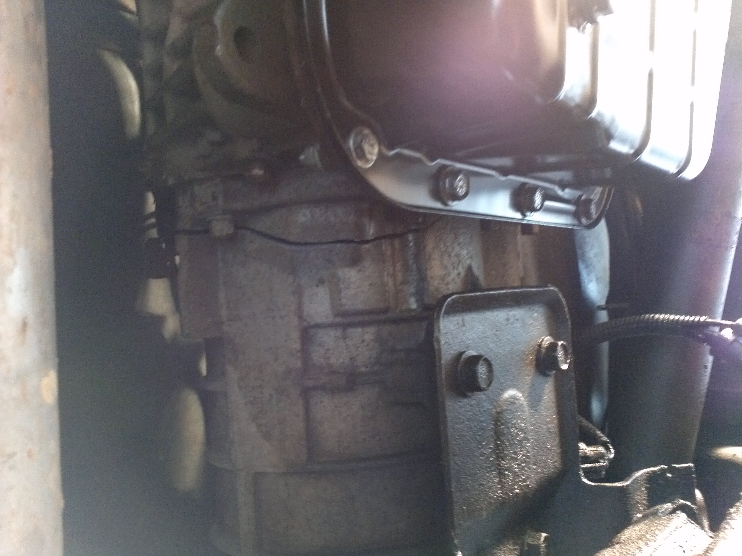

anyone have experience with replacement
47re from autozone, advance auto part, rock auto?
I'm in need of a replacement. not a rebuild kit..the case is cracked..
thanks
-Dave

Dave, you are going to lose the core money anyway with a cracked case.
Where are you from? I do know of one fellow who has stuck 3 rebuilds from AutoZone in already, he isn't terribly impressed to say the least.
It shouldn't be too hard to find a core trans, the RE was built long enough, the V10 is the same as well.

is this just the over drive unit? can this be replaced separatly? sources?

Yep, OD unit, opens up a WHOLE 'nother ballgame. The housing is the same for umpteen years, all 42/46/47 RE units, you can have a trans guy rebuild your guts and drop it in a new case.
Fleabay is loaded with cases if you don't have a good yard close by who will part one out.
PS any idea why she cracked?
