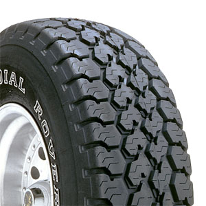

Old Dec 11, 2006 | 02:08 PM
y2kram's Avatar
Posts: 91
From: Phoenix, AZ
Dunlop
I like the Dunlop Radial Rover RV as a good all around tire for street or M&S.
