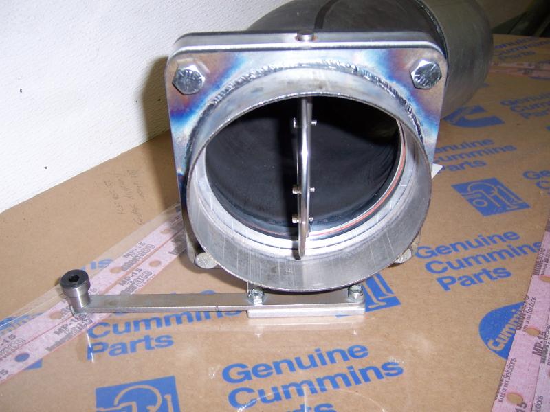

If you guys are serious about a positive air shutoff, I have installed a couple. They are a requirement on diesel trucks used in the oil patch, as there can be fumes in the air that the engine can inhale and run on. They are made by a company called Roda Deaco, and are not cheap, but it sounds like what you are looking for.
www.rodadeaco.com
Also, I have also just found one sold by BD Diesel, who is a vendor here. Here's a link to their page: http://www.dieselperformance.com/ind...uct/index/187P
Old Dec 26, 2010 | 05:49 PM
92smokin blacky's Avatar
Joined: Jan 2009
Posts: 2,128
From: Bountiful, Utah
Wow, I think I could make one much cheaper
Old Dec 26, 2010 | 05:56 PM
JBradley500's Avatar
Joined: Feb 2010
Posts: 1,044
Engineered Diesel makes them. I'd buy from them if I were to run one. They aren't cheap but you're paying for precision and the peace of mind knowing it will work when you need it most. IMO of course.

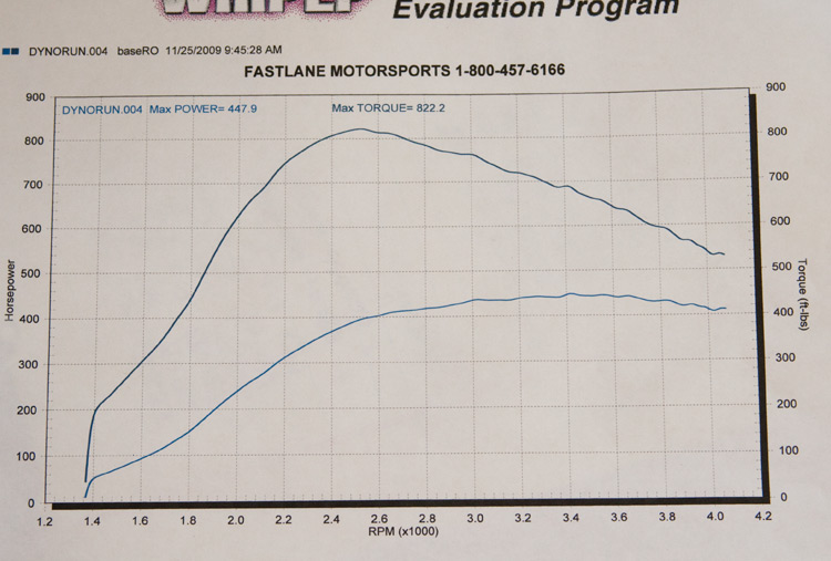

The fuel doesn't necessarily roll-off sharply after 3500 (clipped 3200rpm spring) .. . .

The ED air shut-off is a nice unit . . .

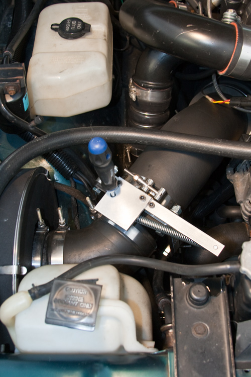

Notice the high-tech activation mechanism
