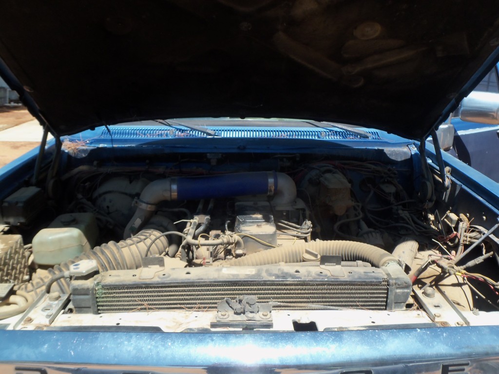

So after all the back and forth i went ahead with the he-351 and what an awsome choice it was! I installed an intercooler from a porsche and some custom pipes to hook everything up. I also made a custom bracket to keep the wastegate working with a boost controller. I wanted to be able to run boost at where i felt was the most fun to drive.
Long story short i had it all together for about a day and a half and smoked the trans. I knew the trans. was the weak link but i figured it would last longer than a day. Any way the cummins is amazing with my setup and i appreciate all the knowledge.

It was enough to kill the turbo 400. So now I've ordered a high performance turbo 400. Should be here today for install soon. Im gonna do a thread based on turbo 400 behind 6bt soon to go over what needs to be done to make it work. Heres some pics of the completed cummins installed and done right with the he351 turbo.

If you get rid of that intake horn I bet you'll get more power.
Just a note; if you could get an intercooled water neck your top radiator hose will be much nicer (at least I think it will. The pictures are messing with my thinker).

I love my 89 intake and purposely left that as the focal point when you open the hood. I know that it is restricting but I've heard its good up to +/- 450hp. I dont think Ive hit 450 so Im good for now. Plus I cant even handle the power I've got now. Did I mention also that love it?
Does the intercooled neck do something different? Fill me in here.
Fixed my pics. Sorry.

The later intercooled metal radiator necks have a 90* bend that directs the neck behind the fan rather than the NON intercooled neck that send it forward.
It just would cut down on the custom radiator hoses you have set up.
That is a wild intercooler set up - nice work !
Thanks Oliver, Ill look into that intercooled neck.

do something like this instead of all the hose ?
