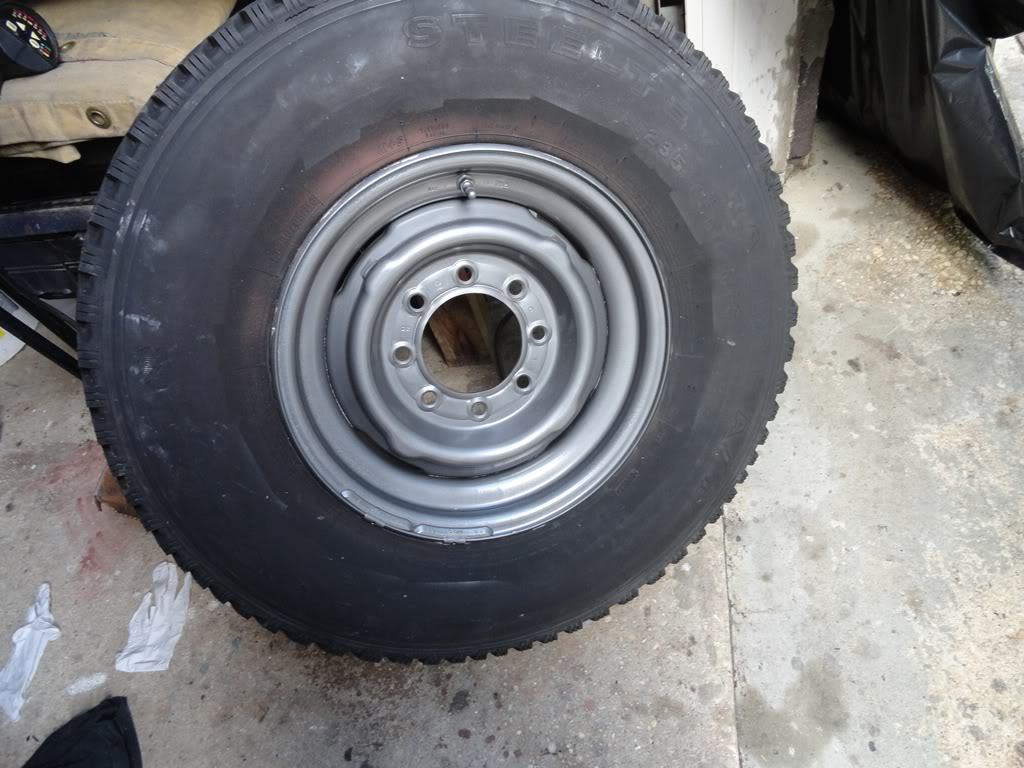

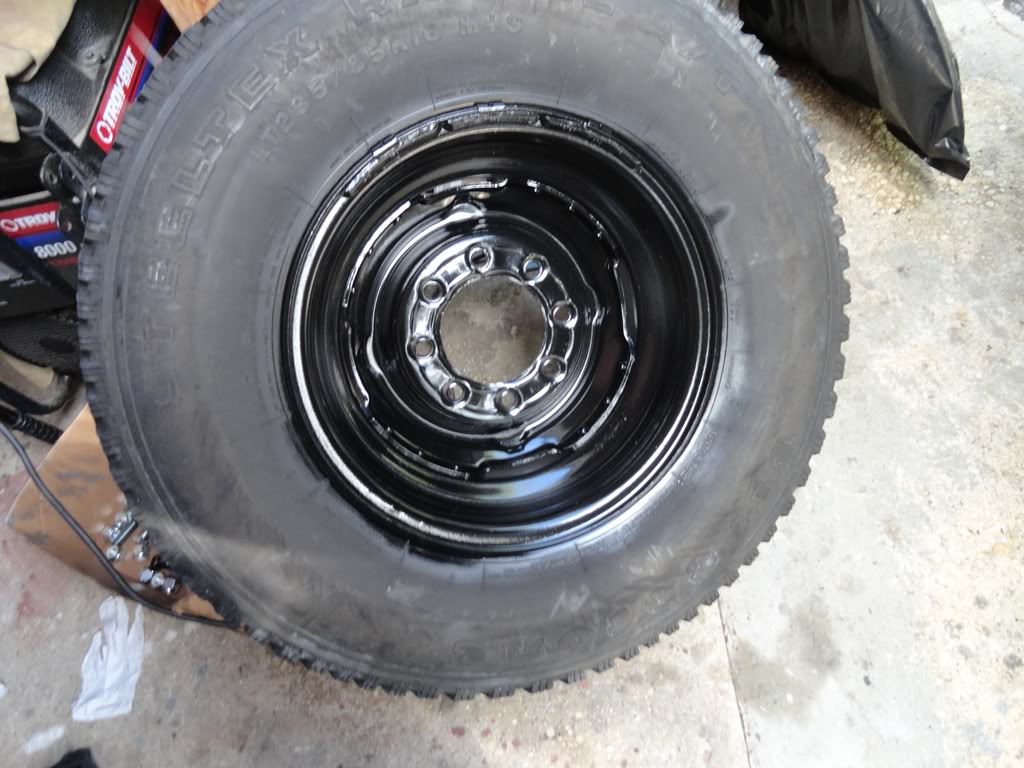

Old Sep 26, 2011 | 07:44 PM
I think they came out ok
Considering they're going to just get cap and rings anyway
Old Sep 26, 2011 | 09:59 PM
BearKiller's Avatar
Posts: 6,457
Likes: 95
From: KENTUCKY
Looking good !!!
I told the wife that it seemed a shame for me to hide all of my hard work and shiny black paint behind the stainless simulators.
Did you paint with the tires on ??
I removed the tires, as I wanted to really concentrate on the bead flanges where rust seems to take hold first.
No rust on my rims yet, but I wire-brushed off at least a 1/4" layer of old tire residue from the bead seats.
The hidden insides got the same treatment as the show sides.
I have a BUNCH of wheels yet to go; I hope I don't run out of enthusiasm before I start the next pair.
Old Sep 27, 2011 | 05:04 AM
Looking good !!!
I Maaco'd them.... with the tires on. These tires are junkers and aren't going to be reused coming next year. That's why I was so interested in your "tire thread".
I used my foam sanding blocks to get what little rust on the rim there was off. Taped off the rim, and sprayed away.
Most important thing is to let the paint cure... so it will be resistant to the hubcaps and trim rings being reinstalled.
T.
