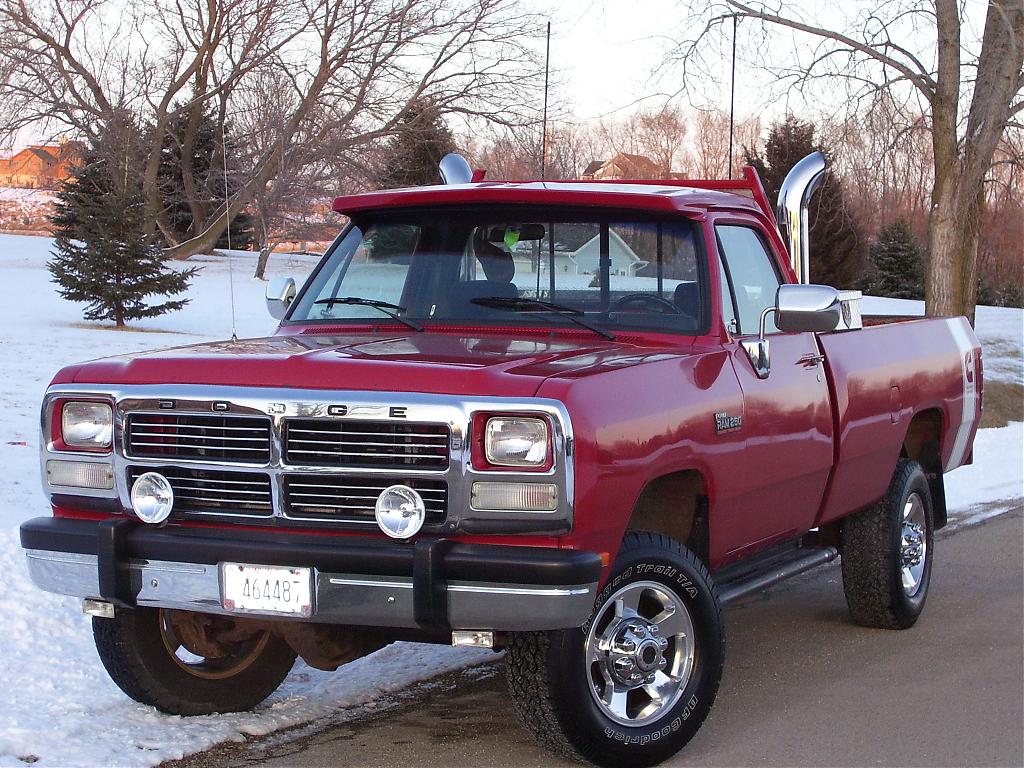

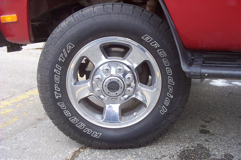

You will need spacers! I put 1.5" spacers on. The ones I bought had 9/16 lugs in them instead of 1/2". That way i could use the stock 3rd gen nuts, and use the hub caps. i cut holes in the caps for the lockouts and they look real sharp. Check my profile out for pics!
Old Aug 2, 2009 | 11:51 AM
schamran's Avatar
Posts: 2,081
From: Wisconsin
ok, for whatever reason my profile doesn't have my pics....
Here...
Old Aug 2, 2009 | 12:06 PM
jimbo486's Avatar
Posts: 4,389
Likes: 114
very nice, clean truck!! i like the location of the lights on the bumper.

I'm diggin those rims. Where might Ia guy find those? Schamran, I PM'd you today about your rims. I see now you used 1.5" spacers. I just need to get put on a location for the rims.
David
