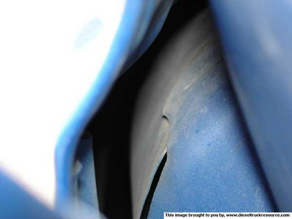

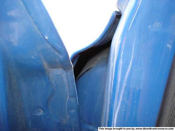

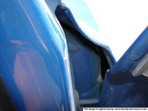

cowl crack pics
Here's some pictures of the cracks on my truck, it's no wonder the carpet in the footwells gets soaked when it rains. Although, I have figured out that if I back my truck into my fairly steep driveway that it doesn't leak through.
driver's side:
you can see the door on the left side of pic and the A pillar on the right, looking toward the left front fender
closer look
Passenger side:
you can see a crack and barely visible to the right and above is a pretty large hole.
closer look at crack and large missing piece of metal

ok mine has that too. Looks almost like factory not like a crack. Maybe I'll have to get the Borescope from work to check it out.

That void is where the panel comes together, sloppy fold, stamping etc, whatever you want to call it. The cracks are above and/or below that void, mostly above from what I have seen. People may hear a popping, creaking or cracking noise where the crack sort of buckles with the road vibration or body/chassis movements. AKimmel has a post with photos at TDR, the best doable repair resembling the OEM "cowl crack panels" in my opinion.
