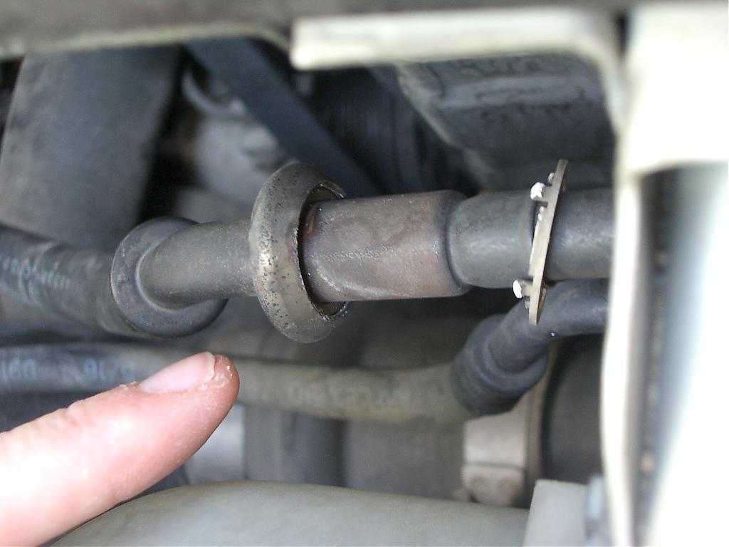

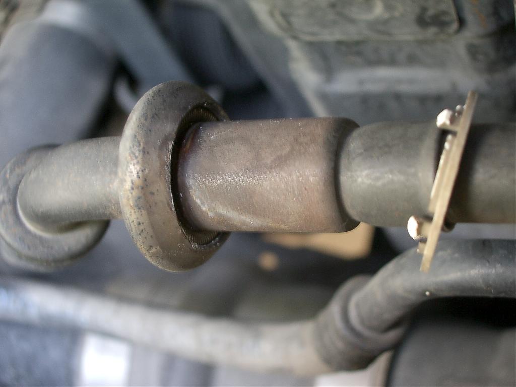

First let me just say this website is my second favorite thing besides my 91.5 D350. I have been getting tons of useful information about mechanical problems that I've been dealing with. I'm new here so thanks for putting up with a newbie. I have searched the sticky looking for an answer to a particular question I have but not quite finding anything specific.
Recently I lost all cooling in my A/C system. After reading some of the common problems addressed here I did a quick inspection of my cooling system. What I found was a loose fitting on my A/C hose assembly. I only have gauges for r-134a refrigerant and I don't want to commit to permanently attaching them yet as I would rather keep running r-12, so I don't know if I still have any charge left or not. But from the looks of the oil on the hose and how loose the fitting is I'm going to go out on a limb and assume it's empty. The fitting that's loose looks different from any of the others so I took some pictures of it and I'll try to attach them to this reply. The only replacement hose I can find is for a non intercooled engine. Does anyone know if I can get it rebuilt? Thanks for your help!
Attached Thumbnails What do you need to know?-imgp2772.jpg   What do you need to know?-imgp2769.jpg

theres an o=ring inside, you need tool seperate the fitting, but chances are you just need o-ring.
oh and they aint ever rigid, they all ways seem loose.
