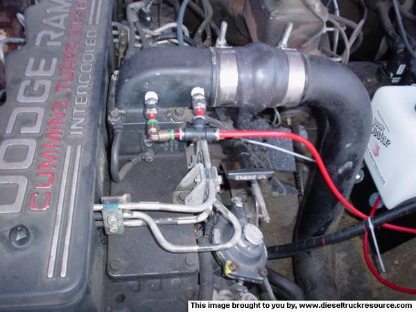

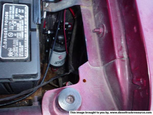

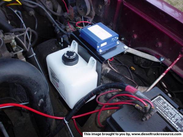

Originally Posted by gcliburn
So exactly how is all of this set up. Sorry I am trying to get a good picture of this in my head, I have never seen one.
Here are some pics of my setup:
Pump (hiding down under the battery)
Controller and reservoir
Nozzles
