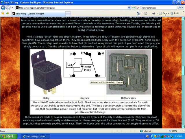

Couldn't find a relay with a diode in it at local store. I have a diode witch line would I solder it in and witch direction to keep voltage from. Thanks.

Try this...
