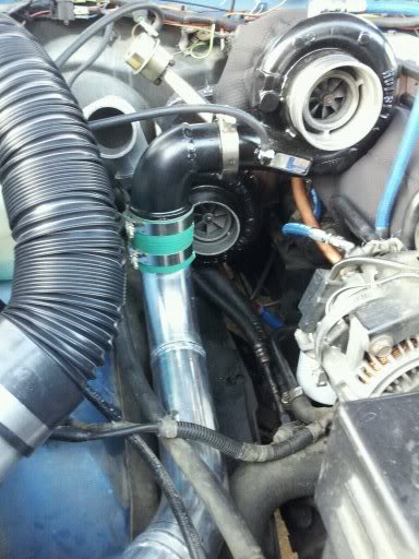

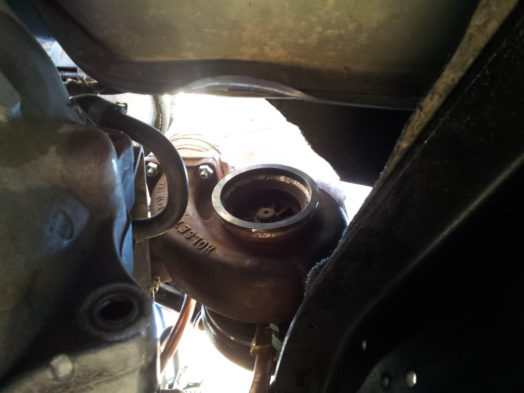

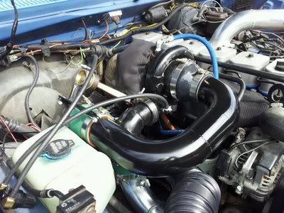

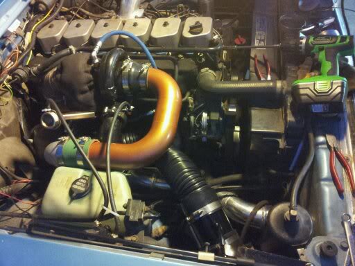

Well the twins are in and tuning has begun. I did have to lenghten the hot pipe to drop and angle the primary slightly as the outlet was heading right for my heater box. All is good though as the cold pipe remained the same. I have added a retaining strap on the secondary discharge outlet and will be adding one from the primary as well since the boots are blowing off. As of now boost is right at 40psi with the primary making around 22psi and the gate opening around 25psi. I would like to see if I could get boost into the 55psi area.
Mods are:
hx35/50
354 spring
7x.010's 158* sac nozzle
~1/8" bump
HP piston pump w/holley reg.
Torqued head bolts @135lb/ft
home ground pin, afc set tight, load screw somewhere near runaway.
Nothing too crazy really, still smokes pretty good. Need to get boost up some. Pics!

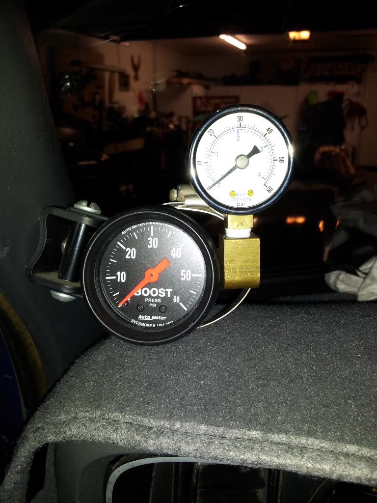

That looks just like the boost gauge I ran for years!
Old Mar 11, 2012 | 03:35 PM
  #40
stillsmokin209's Avatar
Posts: 238
From: California
Cheap and simple! Just using it for interstage pressure.

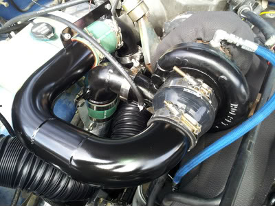

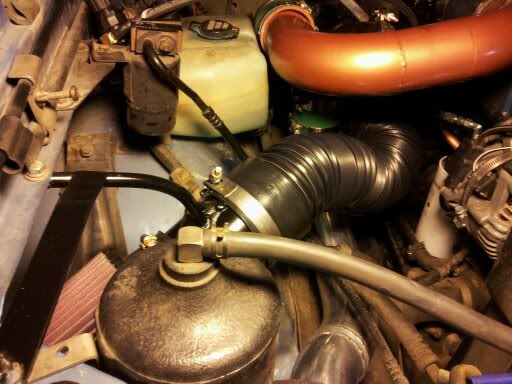

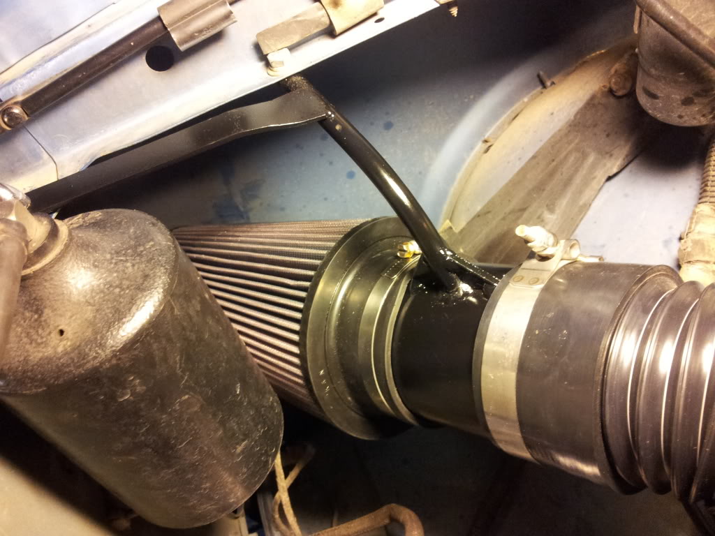

Fixed the blowing boot issue, ended up painting it all black.
