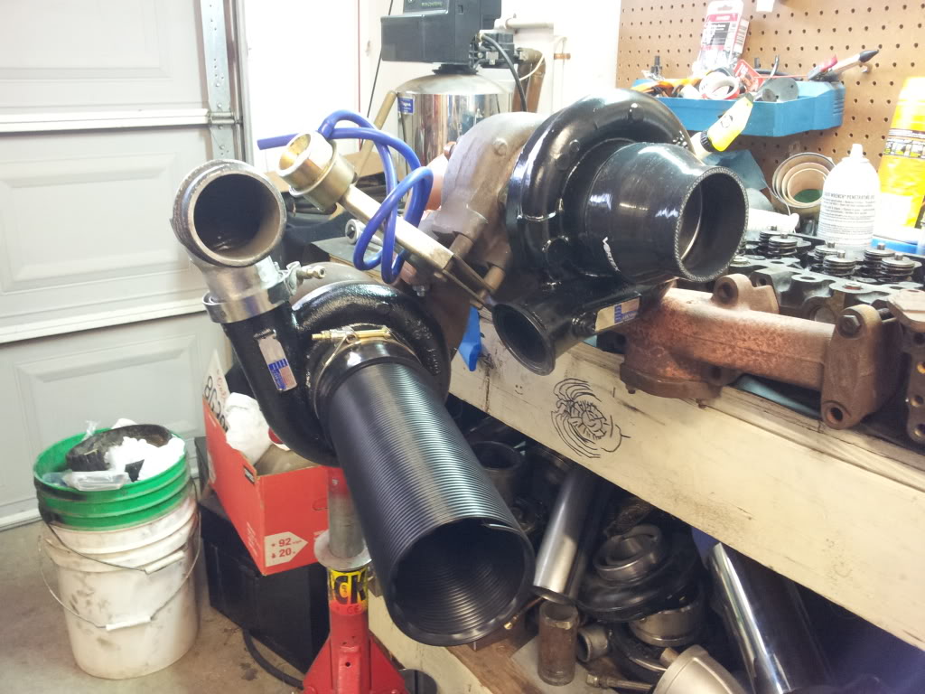

where you considering using this set up to vacuum the shop floor?
J/K. had to call you on your convoluted
Actually that stuff is made by Spectre, I got it as payment for a few finishing touches (welding) on a friends pre-runner before the upcoming race in Nevada. It extends to about 40" and collapses evenly and easily. Also got the filter from him. The tubing is pretty sweet in all honesty.

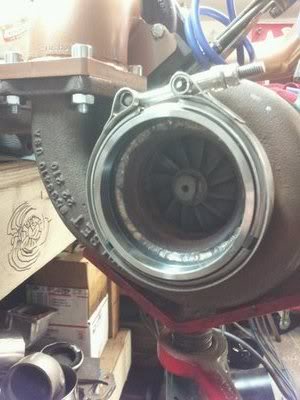

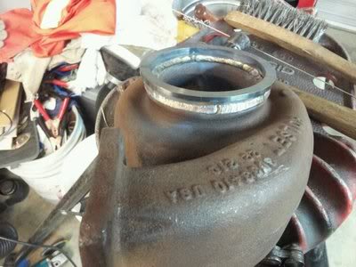

Got rid of the 5 inch outlet on the 55, welded on a 4 incher. Much easier to fit the downpipe this way.
Should make a little progress tomorrow, oil drains and feeds. Can't really do much else until they are in the truck.

Likes: 135
Is that braze or weld?
Old Feb 26, 2012 | 04:38 PM
stillsmokin209's Avatar
Posts: 238
From: California
Weld, 309 ss I believe? Could be 308. I could check if you'd like.
