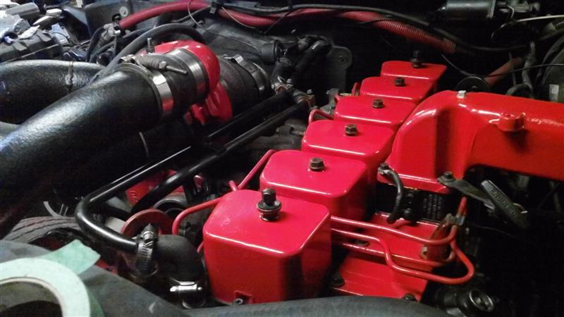

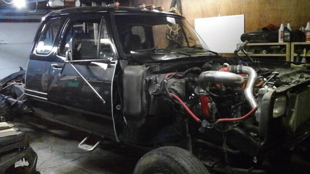

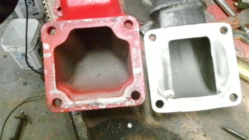

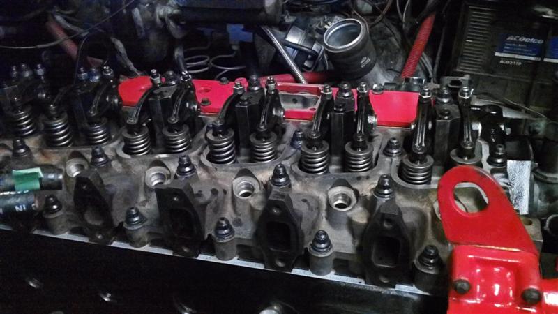

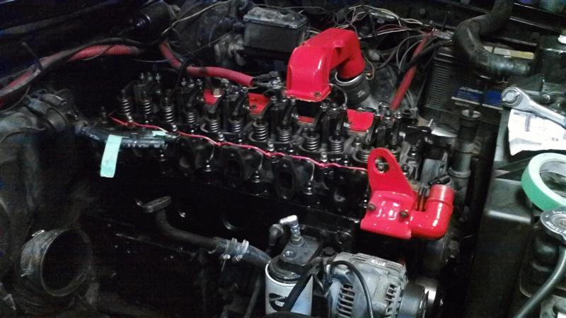

ok going in forward direction again and i can see the light.
afetr taking the turbos off.
i added a rebuild head. o-ringed ,machined for the newer valve seals , decked,magnafluxed,multiangle valve grind, ARP's
got the head on tourqed.......(my arm is tired) lol
its going together slow because i am making it pretty.
valve covers will be cummins apex red as well.
put in new water pump thermostat belt etc.........
the only time i want this to come apart again is for the camshaft and 110lb valve springs. i figured replace the service items now.

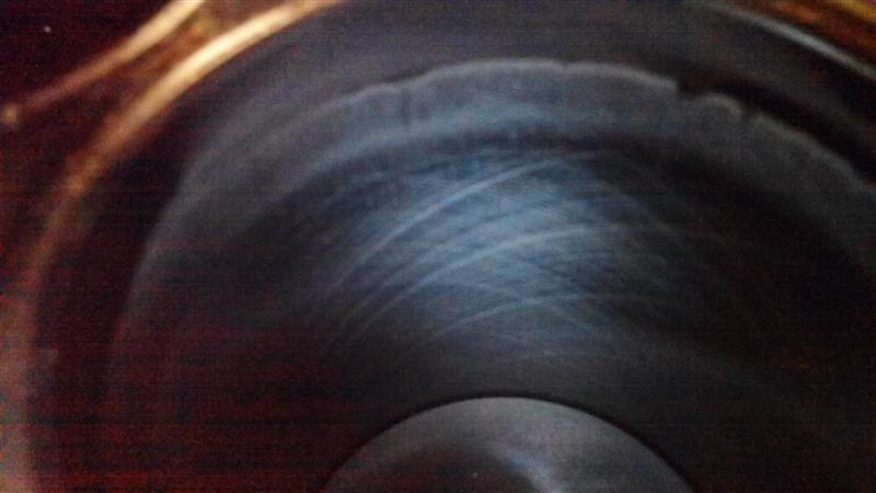

VERY happy with the cylinder wear....or lack of

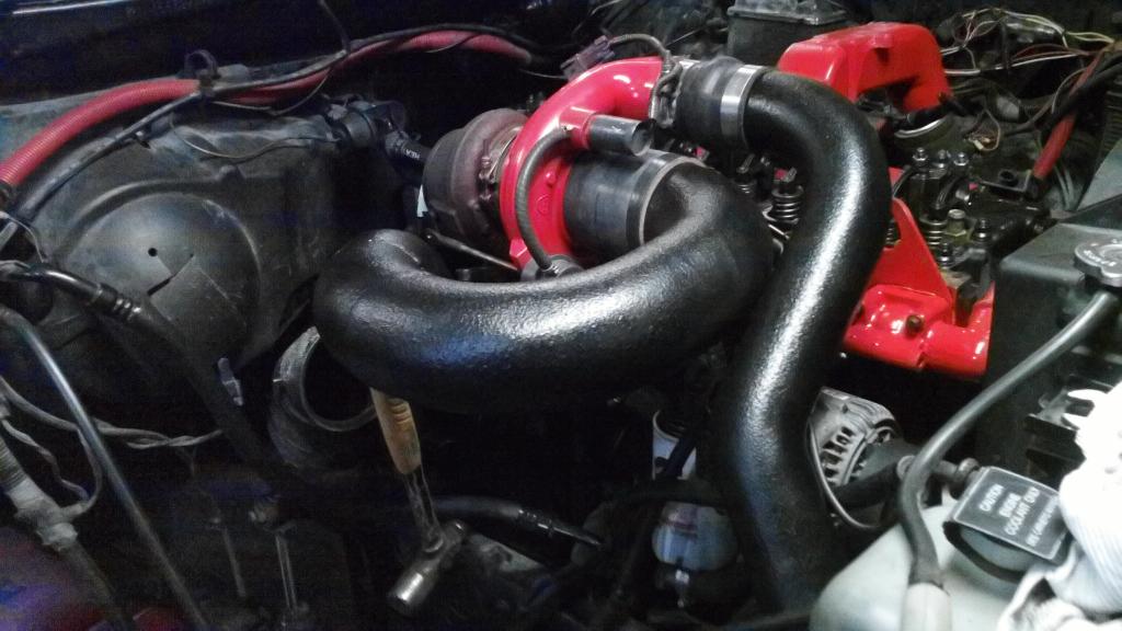

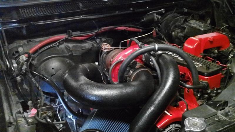

little more progress today.
going to modify my bottom turbo mount.
should be together by next weekend and driving
by the way cummins factory APEX red paint is junk.

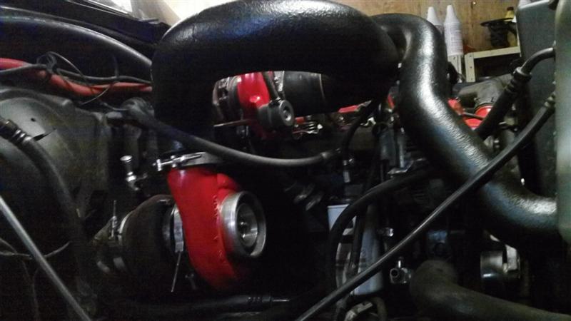

the list is getting shorter.
going to put another big dent in it tommorow

Old Feb 28, 2012 | 01:30 AM
  #83
Lucas1's Avatar
Joined: Aug 2009
Posts: 488
From: Kamloops BC

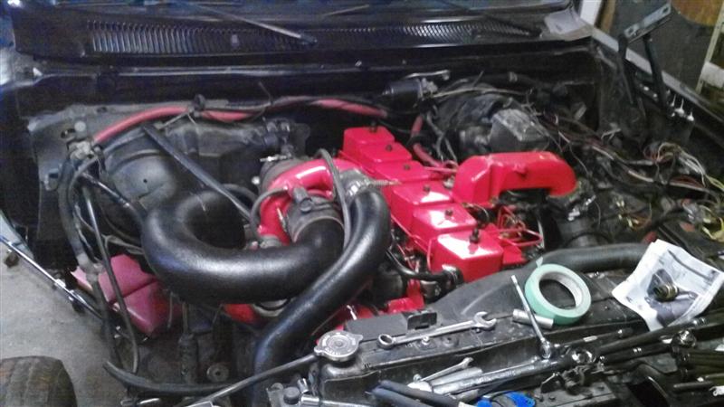

all i have to do is bleed the fuel and turn the key
been a long road
will post a vid of me beating the crap out of it soon
and ignor the giant heater hose .that was just temporary

Crossy's son's Avatar
Awesome!
did you bottom tap the block for the head studs? What did you use to do that? i heard you gotta clean the junk outta those lower threads.
and did you have to get the rocker stands machined down for the studs?
Old Feb 28, 2012 | 09:07 PM
  #85
Lucas1's Avatar
Joined: Aug 2009
Posts: 488
From: Kamloops BC
just tapped not bottom tapped.used compressed air and rag/screwdriver to clean the junk off.
machined the rocker pedistiles so the nuts would drop down
