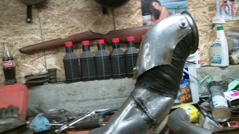

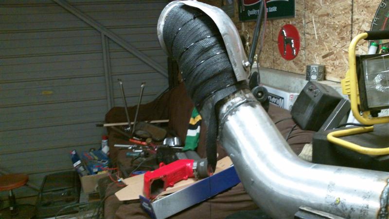

well another day done ...got way less then i expected done.but thats alway the way it goes.
had my down pipe almost perfect then made one cut 100% wrong had it set in the chop saw upside down.
then that let it to be slightly off when i put it back in the truck.= had to "massage" the pipe a little in the vise and took about 3/16th off the frame.
wraped it ...going to get some more and go to the end.
adapter to 4" for now until my budget allows 5" all the way back
also build a shield
fits great and has about 1/4" clearance everywhere.
if i wasnt so crunched for time i would do TONS of things different. but this is my first twin set up......its a learning curve

look how messy my bench is.
i think i am going top do a dark gold or copper pin stripe
