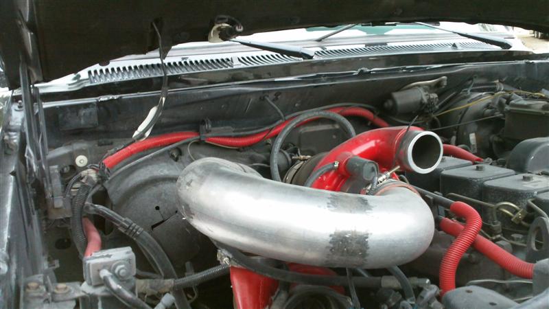

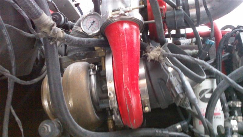

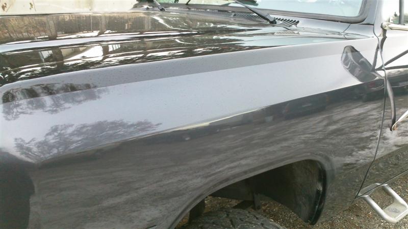

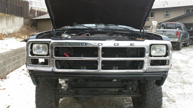

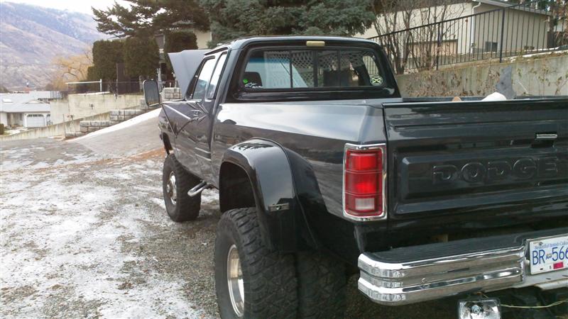

well the body shop is taking a while......at least they are doing a good job.
havent tested the turbo setup yet. but idling an dmoving around the body shop i see a small oil leak at the drain hose to the pan from a crimped hose end....easy to fix.
got a solid three days work on the exhaust intercooler finish and the little stuff after the body shop.

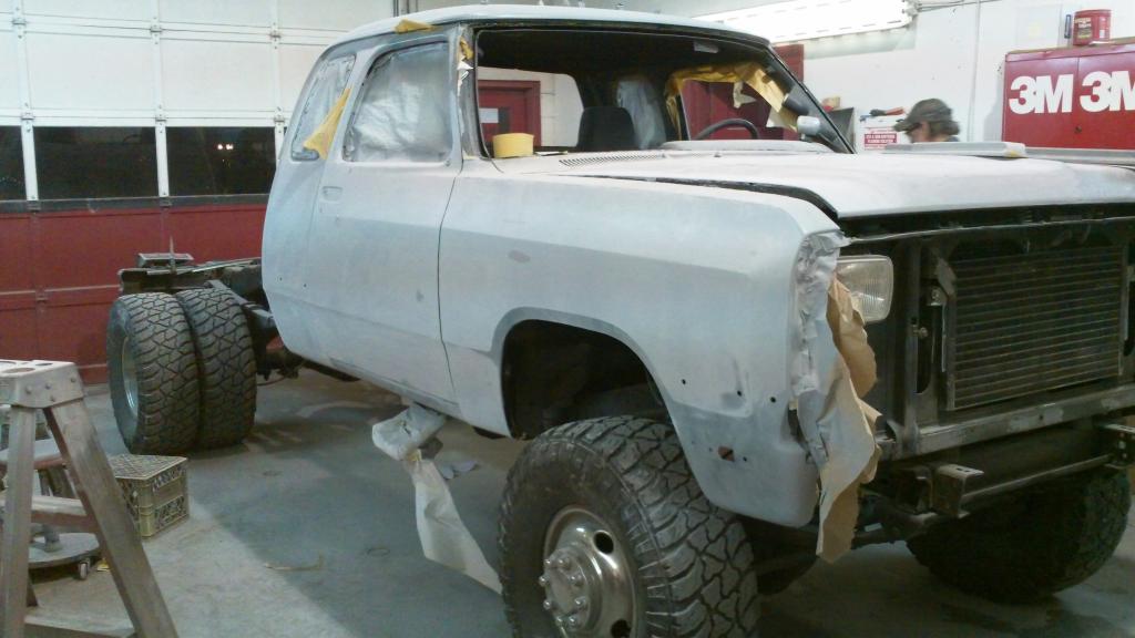

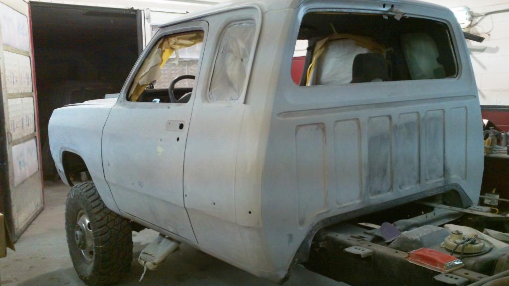

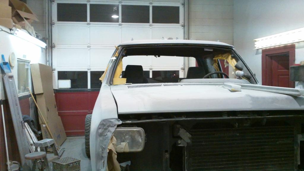

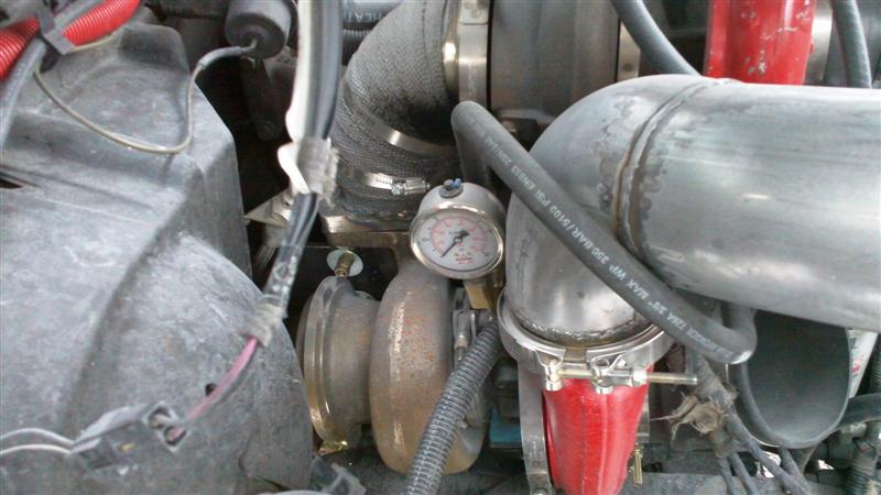

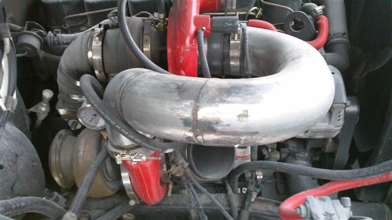

some update pics

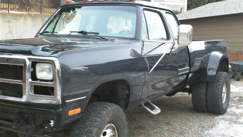

not sure if the LE badging will go back on or the factory ram 350 emblems.
i have new emblems of of new truck . might put 55oo on the tailgate and just the cummins "c" on the fender
and what do you think about pinstrip?
i was thinking Kawasaki green or maybe a dark gold/copper color
cant decide

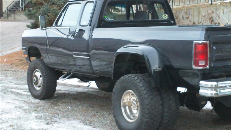

Looking good man! What tires you running? Spacers for the duals.?

The liquid filled gauges will most likely lie to you. I have found any gauge under hood needs to have the liquid drained to read correctly.
