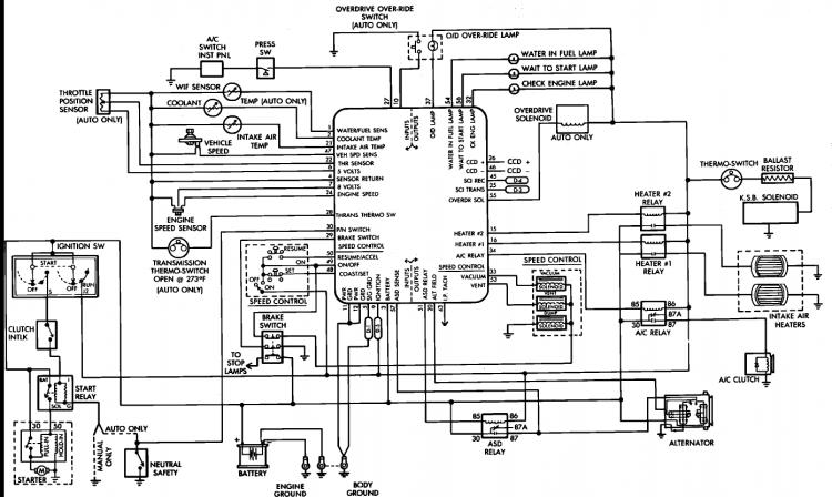

Sounds like an ignition switch problem. Can you give what legs of the circuit you have power on? Or the feed is bad. You say you have power on one side of a 30A breaker but not on the other? And you have power on one side of the fuseable link but not the other side? Or am I reading what you are writting all wrong?

Likes: 23
Think this may help, I'll try to find more they are saved on my computer somewhere.
