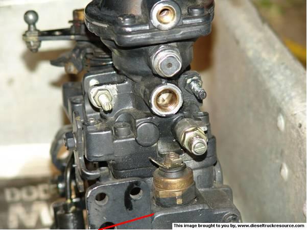

When you get a chance, cut that bracket off that is in the way. Cummins put it there for looks I think. If you dont have the metric wrench for the solenoid, use a 15/16th it is the same size.

Rear view of the pump showing the fuel solenoid and the seal plus the threaded stops.
Fuel solenoid takes 24mm wrench.
This is good advise. It should be a part of every 1st gen owners preventative maintenance. As soon as you buy a new 1st gen or get a new injection pump get a cut off wheel or die grinder and cut the top portion of that bracket off. This way out on the road you can get a wrench at that solenoid in case it fails.
Can some computer savvy kind soul take Jim Lanes nice picture and draw a nice red cut-line on whatever it is that needs to be sawed off, just so I don't saw off something I shouldn't.

On the back of the injection pump directly beside the fuel cut solenoid there is a thick (aprox 1/4" or 5/16") bracket. It is directly attached to the injection pump not bolted on. It is a little tight for space to cut it off, I was able to fit my plasma cutter in there. After cutting it there is a little more space but a special wrench is recomended to access the fuel solenoid correctly.
Thanks.
That's how mine is done. Going through the big hole means less cutting.

Picture appreciated.
