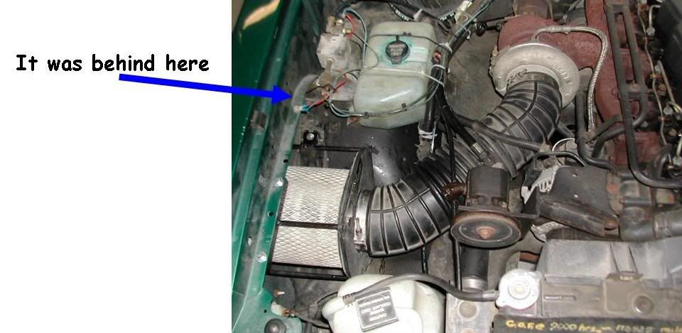

Originally Posted by apwatson50
Why would you take the washer tank off the fender to get at the ecu which is behind the battery on the opposite side?
Um... because it wasn't behind the battery on the opposite side maybe? Mine was behind something, (I don't remember what now, it was in 1999), and then just forward of the hood spring/hinge and partially behind the washer fluid tank, passenger side if I remember correctly.
Here's a pic;
chaikwa.
Hey, somebody stole your air box .
Whats that thing hanging off your alt? Hydraulic pump?
