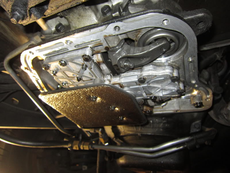

I stopped at the auto parts today and picked up a filter and then this afternoon I dropped the pan to see what was going on inside.
I hate dropping the pan on a transmission because I can never seem to hit my big 30" square drain pan and always wind up with a big mess so this time
I drained the pan through the dipstick tube and all that I had left was about 1 pint in the bottom of the pan and I didn't spill a drop.

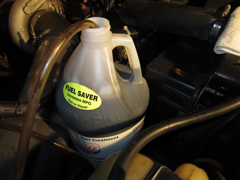

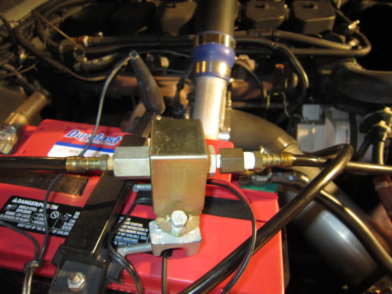

Here I use an electric fuel pump with 3/8" PVC hose on both ends, I dropped the suction suction tube down the dipstick of the transmission about 30 minuets after I came home so the fluid was still nice and hot.
Reminds me of pumping ones stomach.
The discharge side I simply had fill a used 1 gallon plastic bottle for storage as I am going to reuse it.
Now I could remove the bolts and drop the pan without having it full of hot oil.
I also have a drain pan under the trans to catch the millions of drops of oil that will drip for the next hour.

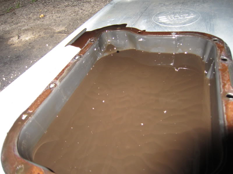

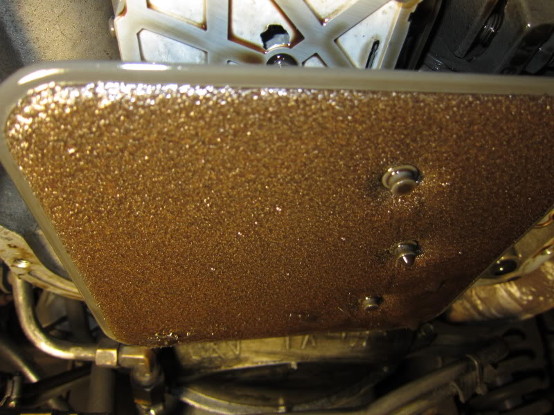

And again the fluid is not nice and red the way I thought it should be, there is less than 50,000 miles on this fluid and filter.
Here is the fine metallic mud in the bottom of the pan, I would assume it is a combination of clutch friction surface, bronze from the bushings, ferrous metal from the drums and torque converter, the slivers of aluminum , that I am not sure but it does look kinda pretty, pretty expensive.
Here is the filter, there was a bit of metal on the bottom where it sits against the pan.
Here are the filings I found with my magnet, mysteriously the magnet in the bottom on the pan is missing.

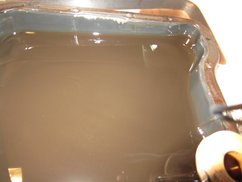

This is sure not the color that I remember Dexron III to be it is NOT burned but it just looks well used.

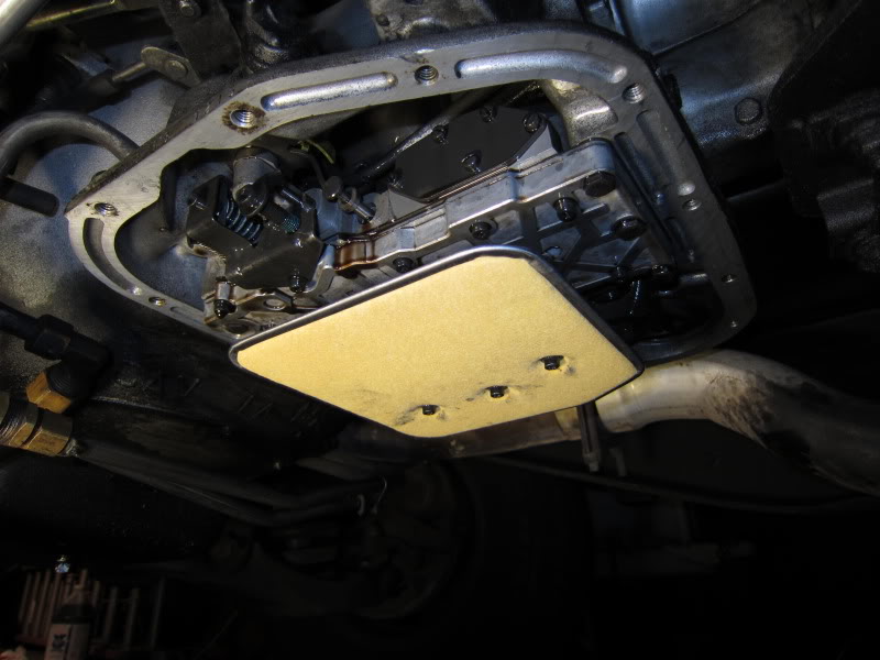

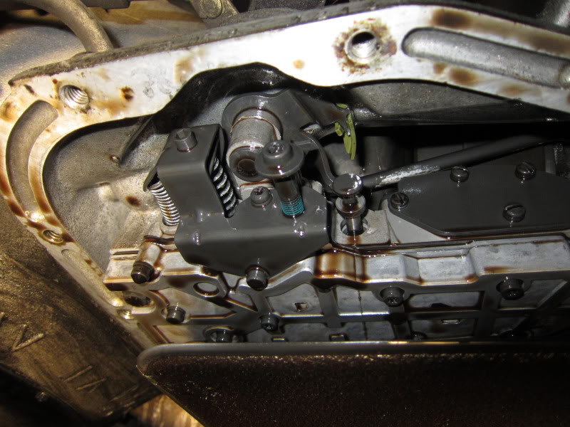

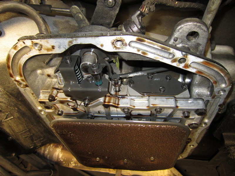

I looked into the case as well as I could and I did not see anything broken where the shavings might have come from.
I replaced the filter and cleaned it up and then I replaced the pan.
After I got the pan on I pumped all of the fluid back into the trans that I had filtered through a paint strainer and went for a road test,
As I knew it would do, it still slipped when it was cold and then it started working fine after a few miles, at least I only wasted $5.00 on the filter.

I know people who had driven their vehicles over 190k miles without ever having replaced the trans fluid. Now, in that instance I'm surprised it even moved lol
50k miles is a lot, but not overly excessive if it's driven kindly imo. The trans color is about right I'd think, for that many miles.

Trans fluid almost looks like its contaminated? Was there more than there should be? Sometimes that heat exchange heater thing along the right side of the block can leak and allow coolant/AT fluid to cross.

What temp does your trans run @ while driving, in traffic, etc ? Looks like overheated fluid to me.... or somehow moisture entered into the trans.... which is unlikely.... but that's what it looks like....

I know that you are meticulous so I wonder where is the pan magnet?Also, the color bothers me.
I change the autos (of family members) every 25K and have never seen that color. Is it possible that when you power wash that water is going down the dipstick tube. Take a sample to your tranny expert.
