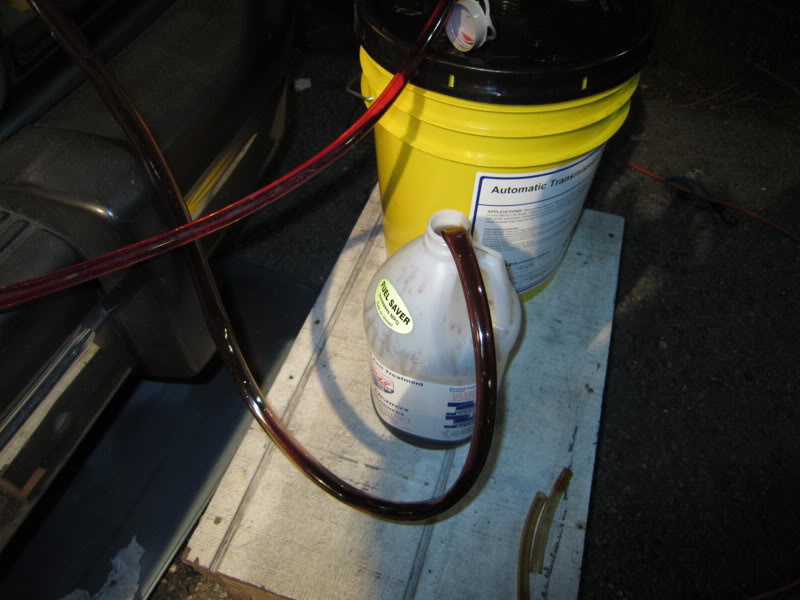

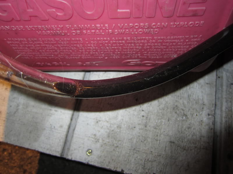

Ok so last week I was finally able to flush the transmission, I actually pumped 6 gallons of ATF through this thing until it was clear enough for my liking, I still need to drop the pan and replace the filter, adjust the bands and drop a few rare earth magnets into the pan.

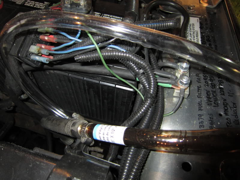

Here is where i disconnected the lines from the front cooler, I connected to both of them so I could determine which one was the pressure side, it turns out to be the top line feeds the cooler.

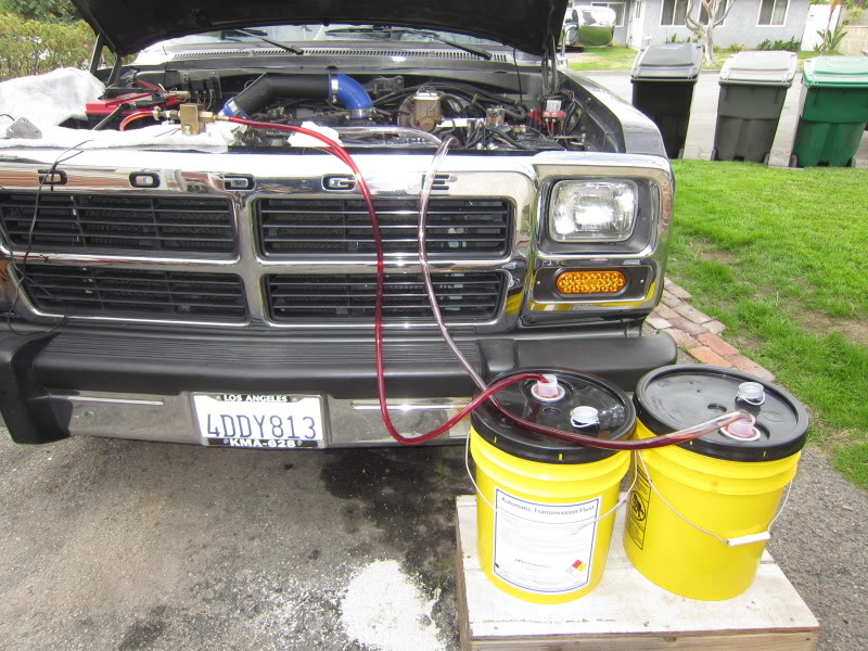

Then once I found a container sufficient to hold the old ATF I had my wife start the truck and put the transmission in neutral and use the internal pump to drain the transmission.

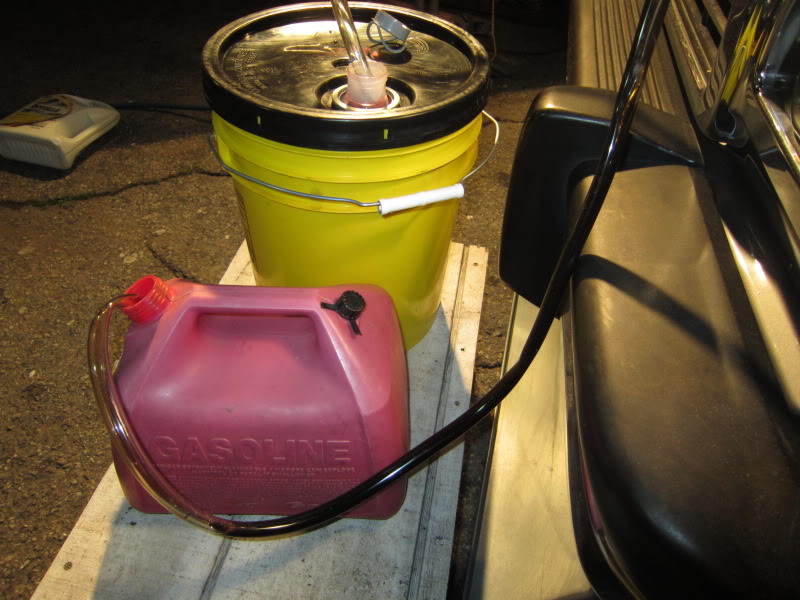

I let it pump out until the pan was almost empty and then I started my pump and kept the trans filling through the dipstick then I would repeat the cycle of starting the engine and pump out the old ATF until it started to come out clean, this actually took quite awhile.
After about 3 gallons it still didn't look like it was getting any cleaner, and I am running out of places to put the old ATF.

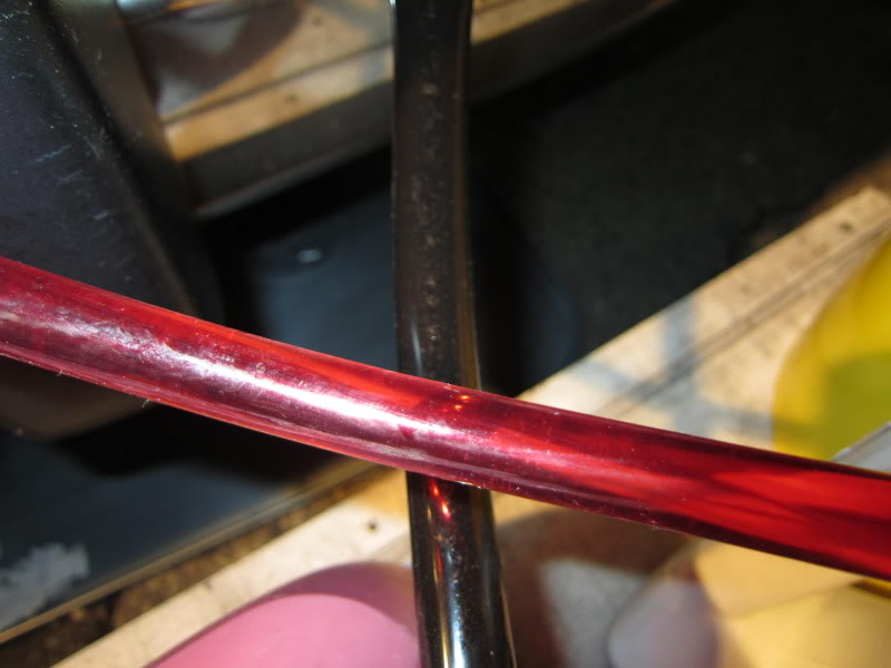

So after gallon #4 it is starting to look better.

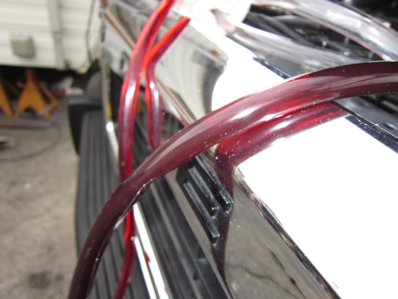

After about 6 gallons (24 quarts) it was about as good as it gets without wasting ATF so I called it good.
Any of the remaining ATF I am going to filter it and use it as good.
