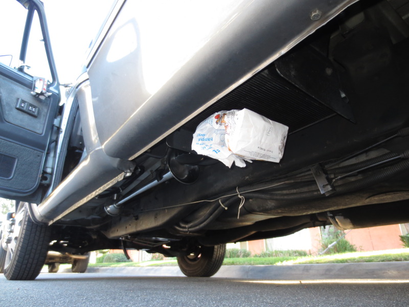

How much air does this cooling fan flow?
I picked up a hitchhiker from Mc Donald's today, just came along for the ride. (about a mile down the road)
Jim

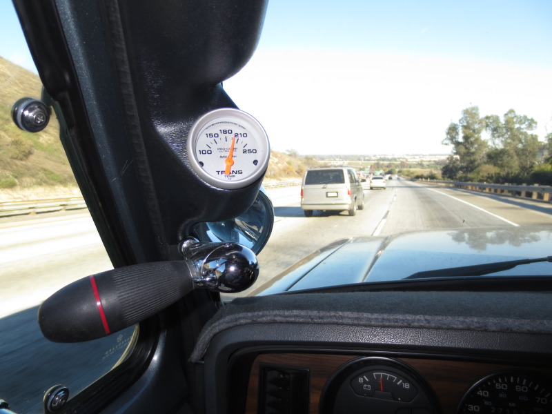

I had to take a trip out to Costa Mesa today, I was cruising at 75 MPH with about 8 PSI Boost.
Jim

Really seems to be running hotter than it should.
