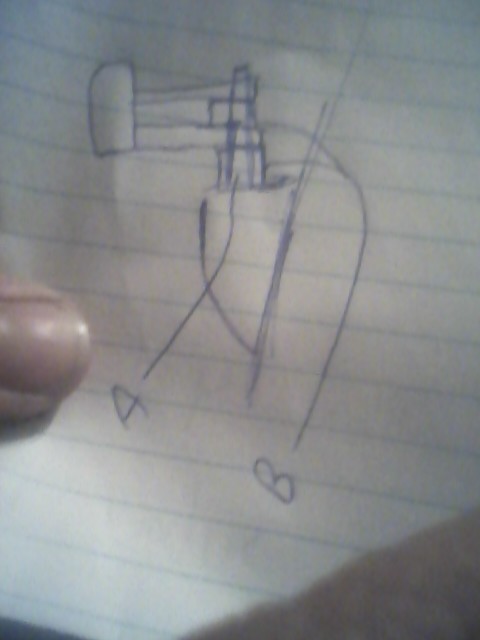

The chevy mirrors may work. IT would take a little doing and depend on tearing the hinges apart without destroying anything.
It would take a shaft (A) and some spacers (B) being made. Be a little easier and better looking if you can swap the top and bottom plastic hinge covers, if the top one is long enough to cover the entire spacer.
And you'd have to either use a piece of tubing for the shaft, or drill the solid one you made, for the wires to be run through.

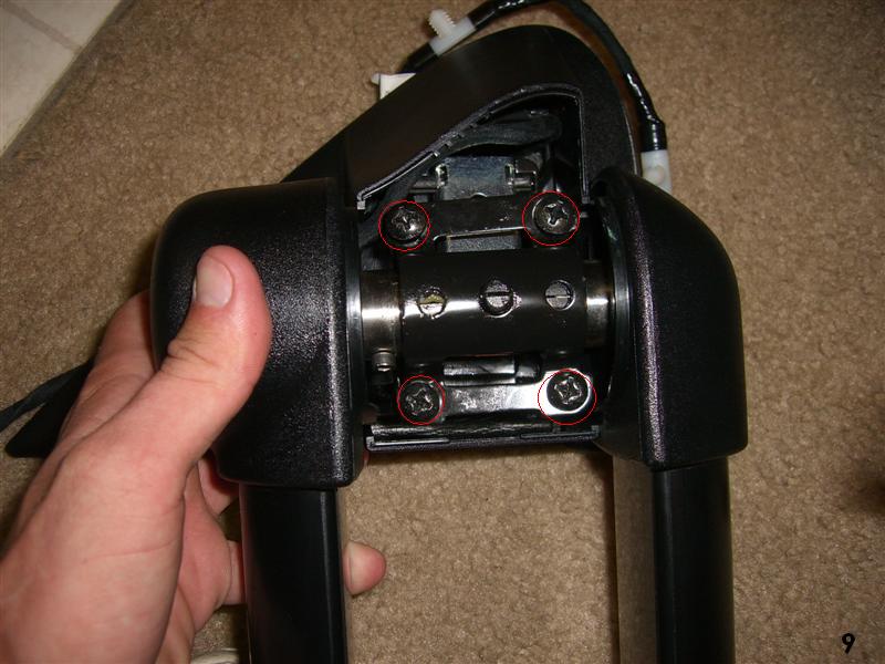

Really wish I could get a complete, detailed look at the mirrors. Found this picture of the inside of them.
Attached Thumbnails Tow mirrors not sure if it will work out but will see-chevy-tow-mirror.jpg

I searched Chevy forums for a bit and saw about the same images. Seems they would just need a hole drilled through the bottom arm. Or both top and bottom to secure them better to the factory mirror base.
