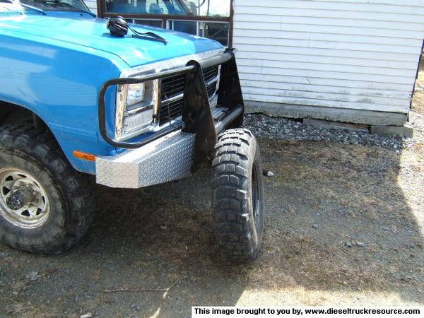

here are some michelin military tires with stock suspension works good
more pics in my gallery

if you dont want to go wide the ones i got are the way to go the are about 36 inches high and 9 wide since they are not wide you can go higher without rubbing and these tires are cheap around here i can get them for about 500 a set
