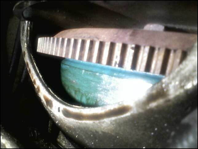

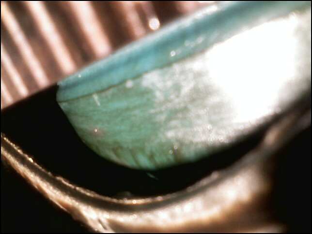

well here are some pictures if anyone wants to check them out. I just pulled the cover off the bell housing and looked up into the tranny and my torque converter is covered with fluid along with fluid leaking out around slightly.
Could there be a possibility that the torque converter went bad and that happened? Or is that just the input shaft seal leaking in there? Would that cause my problems i have now?

Sounds like it wiped the front seal out. Why I can't say, but who ever works on that trans needs to be aware that everything needs to be looked at. It could also be more than 1 problem, it could be several little things that add up.

Just a thought after looking at those pics, the pump seal is most likely the source of the leak, that coupled with you what sounds like a low line psi problem would lead me to be looking for a trashed pump. Probably the T/C bushing in the pump causing the leak and suspected low pressure. Also that fluid dripping off the b-housing is absolutely nasy/brown/mungy looking, a sure sign of crsipy innards unfortunately.
