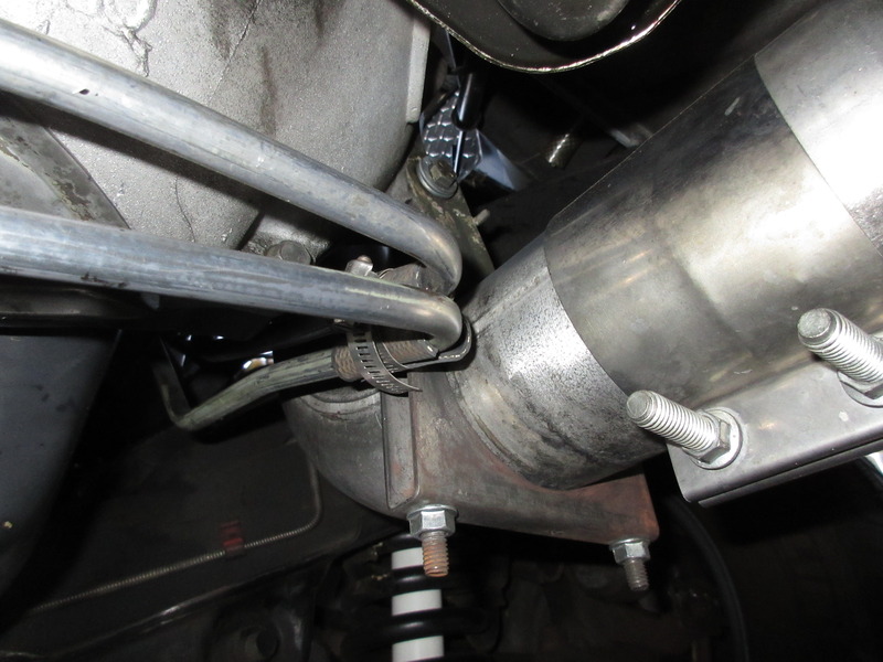

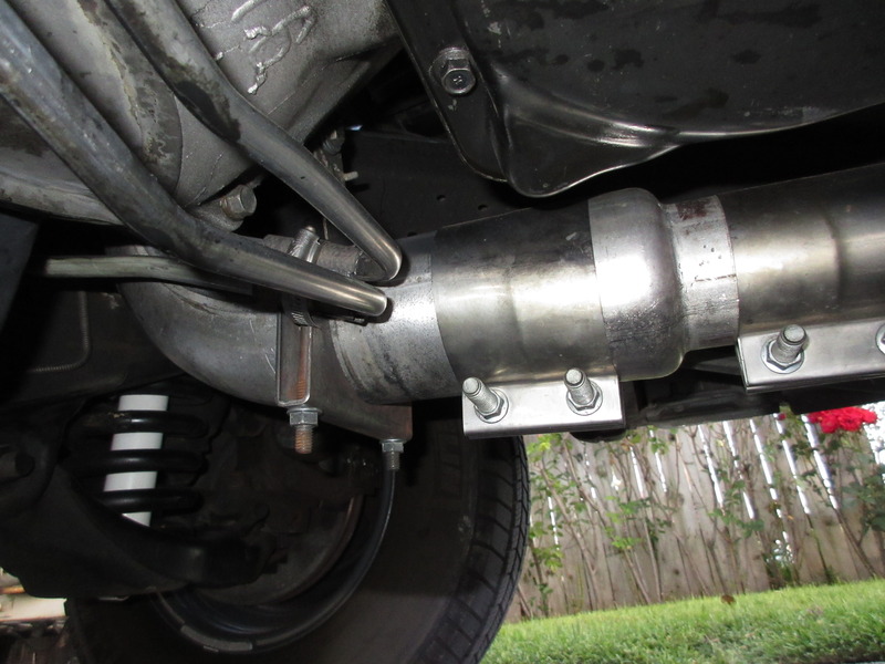

I have a Diamond Eye 4" headpipe and a Banks Exhaust out the back, when I installed the headpipe I made a new hanger from the transmission to hold the 4" pipe, I did not want any unnecessary weight hanging off the flange of the turbo.
Also you need support at this joint because when it is connected to the remainder of the exhaust system, all of the twisting from the engine idling and torque origionates from this joint, some use a section of flex pipe but I do not have room and I do not like rattles so I am thinking about a stainless steel isolator.
Jim
Here are some pictures of how I have secured my headpipe.
The bracket has a small foot about 3/4" bent to the rear against the pipe, the 4" clamp holds it tight.
The pipe from the turbo is in a neutral position and there is no stress on the flange.

Even with the band clamps tight the pipes still twist at different rates wearing on the pipe, I am going to install a stainless steel mesh isolator in here when I get the time.
