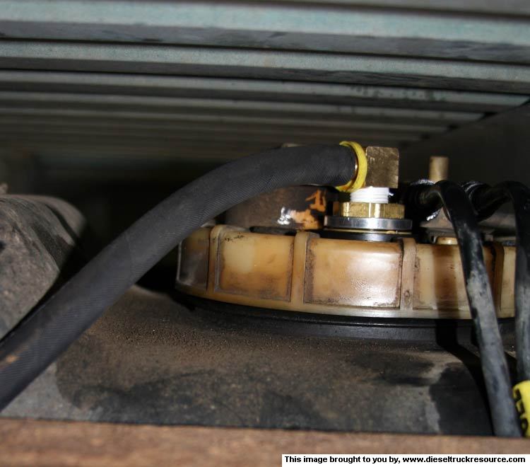

Old Dec 10, 2007 | 05:48 PM
BC847's Avatar
1st Generation Admin
Posts: 4,601
Likes: 118
From: Buies Creek, NC
Hope this helps.

The picture that BC847 posted is perfect... that "thing" is located on top of the gas tank... It is not easy to get to... about an hour to get it out and another couple to put it back...Be patient ...

BC847, do you have that big honkin hose as your new fuel delivery? Looks like its' plumbed into the spare bung, yet I see a quick connect next to it. How does the plastic hold what looks like a brass bulkhead fitting? Seems like it would crack to pieces with the vibs of the Cummins? I've been passively trying to plan a clean Holley Blue pump install on the frame at the tank, but I have all plastic lines and dont want to cut 'em to get the pump in there. I want OE looks and durability.

My fuel system amounts to a piston lift-pump ~ https://www.dieseltruckresource.com/...ad.php?t=93722
That's been modified to provide higher pressure/volume ~ https://www.dieseltruckresource.com/...d.php?t=176472
The plumbing is all 3/8" ID from the actual fuel pick-up in the tank all the way to the IP ~ https://www.dieseltruckresource.com/...d.php?t=151190
I also run the larger fuel filter ~ https://www.dieseltruckresource.com/...6&postcount=16
The fuel plumbing is connected everywhere via AN fittings. The OEM fuel return line is still used in it's original setup. The OEM fuel supply line is now used as the bypass style fuel pressure regulator's return line.
