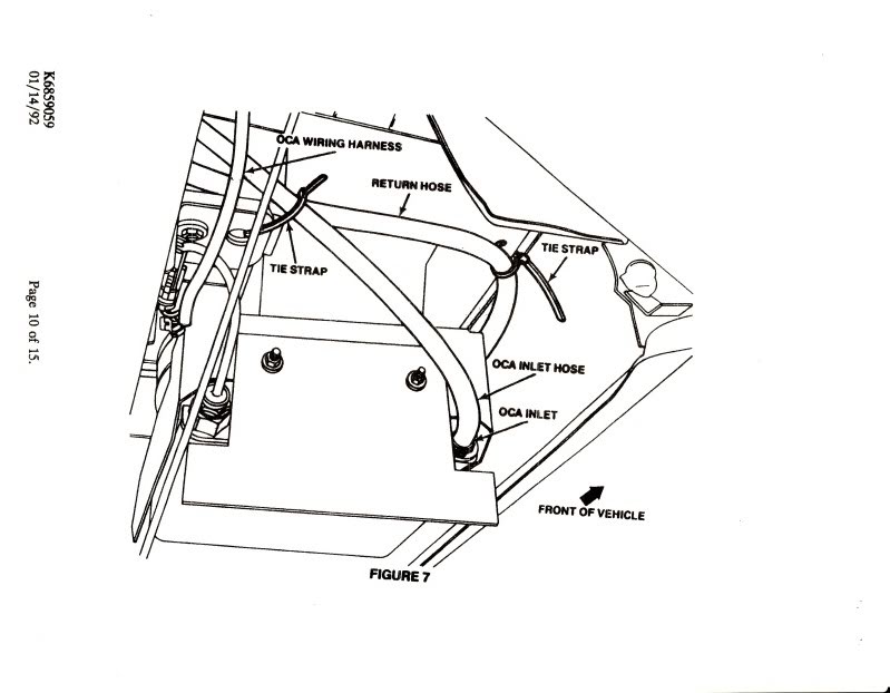

Part-1
Super Duty Transmission Oil Cooler
Here is just a bit more information from my vast collection that I will share with you.
First, I want to thank james1 of Powder Springs, Ga. for sharing this file with me.
This was a $375.00 Dealer-Installed option for increased cooling capacity.
(If someone has a window sticker listing the $$ cost of this option please let me know so I can include it in this post for your information)
This cooler provides additional engine cooling and increases the maximum trailer tow rating from 12,000GCW to 14,000GCW

This was not a factory installed option, but a dealer installed one,per a TSB. Hence the instructions to cut and splice into the cooler lines. I was going to post these same pages that came with an NOS cooler I bought, but mine have a hole right inthe middle of each folded page that made them difficult to read. Thanks for posting this. For those asking about routing the lines, note that the SD cooler goes inline between the output of the trans and the heat exchanger mounted to the block.

That H-Valve is not thermostatically controlled, nor is it really a "valve" in the traditional sense – is simply an H-shaped piece of hollow steel tubing.
The operation of this piece of tubing was explained in another recent thread but it is directly related to the viscosity of the transmission fluid – the hotter fluid flows more freely than the colder fluid and that governs which leg of the "H" the fluid flows through. I would think that if the H-Valve is truly a closely calibrated size, then one should stick with OEM tranny fluid and not use something like Royal Purple synthetic, which probably is a different viscosity.
