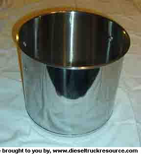

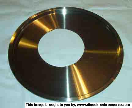

I took a standard 33 quart stainless stock pot that was as tall as the BHAF plus a little, and was big enough in diameter to hold the BHAF while still allowing room for good air flow.:
This is the filter I'm using ( I got it from these guys). ;

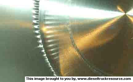

I had to shorten the pot so it'd fit the filter, plus room for some gasket material. I did so by cutting it to the right hight, and using some HVAC sheet metal shrinker's, corrugated the tube so that it would plug-in to the bottom.;

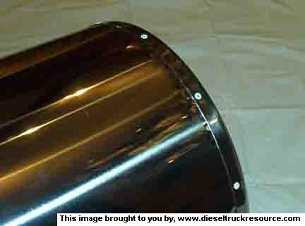

Some rivets hold it all together.;

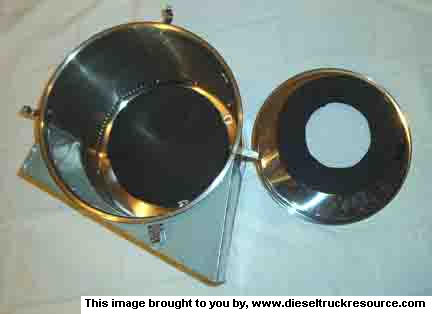

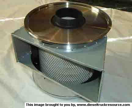

Now's the fun part. I added a duct that would expose as much of the air filter to a good-sized opening to outdoor air. I used the sheet metal that is used in making the seamless gutters as it was heavy enough for rigidity, yet still be reasonably workable. It took a few minutes and a number of cardboard templates to figure it out.;

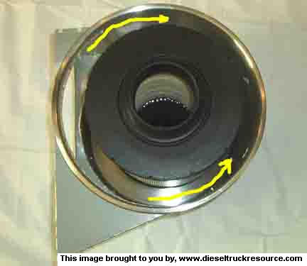

The filter element is offset some so as to allow the incoming airflow equal opportunity to get to all the filter media without undue restriction. It'll also help give the turbo feed duct room to get past the radiators reservoir.;
Having said that, the hole in the lid is cut off center.;

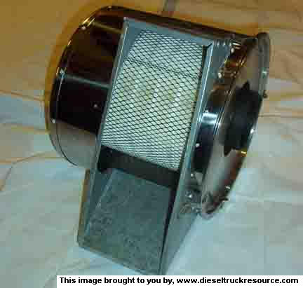

So this is what we have so far.;
With that, we can now add some 3/8" thick Rubatex sheet insulation for gasketing, a couple of L-brackets for the filter to sit on when installed, and some SS spring loaded clips to hold the lid on.;

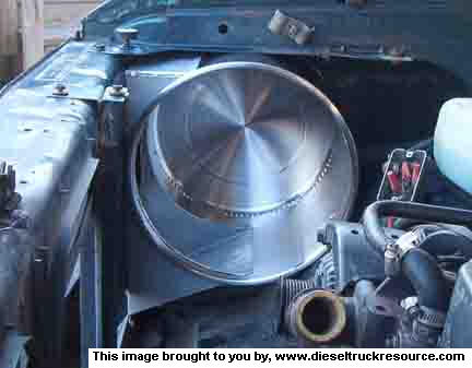

It's now ready to install.;

Now to be fair, I did have to grind away any high spots of the front bulkhead so as to allow the duct flange to fit well against the bulkhead. I also found it helpful to dimple the fender well to give a little breathing room. ;

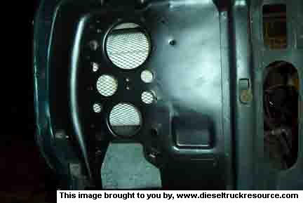

I cut a number of holes in the front bulkhead so as to allow good air flow without substantially weakening the bulkhead.;
With all that, there's plenty of opening for good air flow. ;
It's kinda hard to see, but with the lights in place, there's ample room for good intake behind the grill.;
Finally, I did have to move the radiators reservoir toward the radiator 1/2" to allow reasonable room for the cold air box. The only problem that I see is I'll have to remove the reservoir to change the filter. Oh well. That boy's in there like a hair in a biscuit! ;
