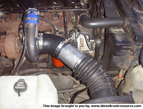

Does anyone have a stock tube that they arent using, i kinda sorta mangled mine.

91.5-93 stock intake tubes are sorta hard to come by with all the nonIC'd guys adding hx35 turbo's with 4" intakes vs. the 3" intake on the nonIC'd turbo. You'll probly have a hard time finding one. Your best bet would be to build your own. Couple 4" 45* elbows and straight piece of 4" exhaust tubing. Someone will chime in and maybe post a pic of what I'm talking about.

Wannadiesel's gallery to the rescue!

I have a setup just like Wannadiesel's and it is a PITA to R&R!!

Doesn't fall off though.

Here's how I did mine.
