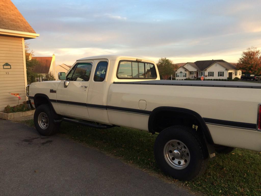

I just purchased a very clean 1993 W250 4x4 diesel. The truck has zero rust. It does have a couple of issues that need addressing. The first one I am going to tackle is steering. The second is ride and suspension. It has the original springs. The ride is flat out terrible.
I have a fair bit of play in the steering. After reading this forum, my understanding is that if I replace the stock steering shaft with a Borgeson Steering Shaft it should help correct this problem. Has anyone done this and did it correct the problem? The alignment appears to be fine. I am going to take it into a 4x4 shop and have the other front end components inspected and the alignment checked.
