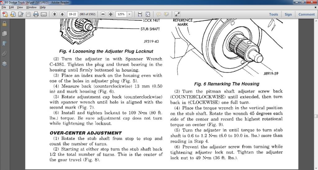

Note in step 5 of the over center adjustment, we're looking for 6-10 inch lbs increase in torque. Seal drag is about the same. It should turn with finger tip pressure on the splines.
The adjustment is the screw in the side opposite the pitman. The adjustment can be made in the truck, with TLAR measurement (That Looks About Right), but you'd need to drop the pitman arm and input shaft first. That's really not a big deal. You already have the input shaft disconnected.
Unfortunately, running way too tight for a long period of time often trashes the ball screw assembly to the point that it's not worth rebuilding.
