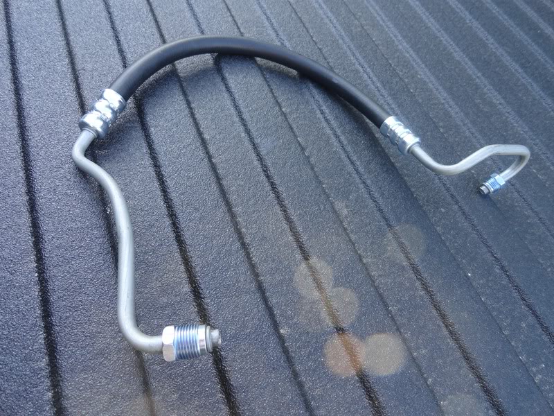

Since I can't edit my post any longer, I just thought I'd post the final hose configuration for pressure line.
This is what the hose should look like to fit as intended.
