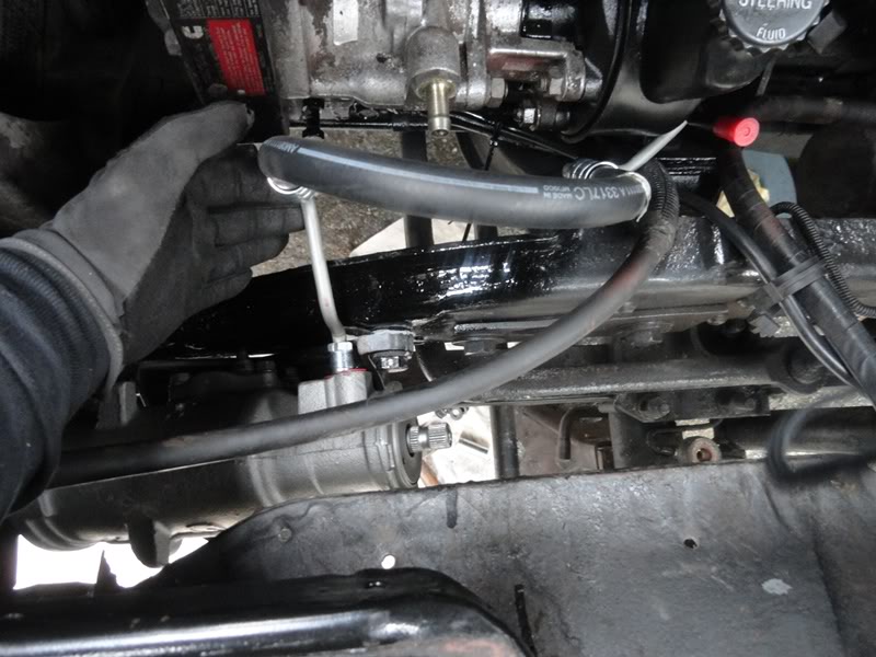

Next was the steering pressure hose and return hoses. Since the OE pressure hose is formed for a different orientation to the gear housing, you either have to modify the pressure hose, or make some changes to an SAE fitting on pump and gear. Either way works, as explained below.
At first I modified mine, instead of taking a little more prep work on the hose fitment. I didn't get it right the first time, and even with my tubing bender, I kinked the steel line. I then used the damaged pressure hose as a "template", which I'll explain further on.
The template hose fits perfect (pic below), orientation wise. BobVA and Papecat changed their pump innards to accommodate a dodge hose from an older truck, but I decided to modifiy the OE hose, and keep the pump and housing metric. I didn't want to modify a rebuilt pump, as it voids the warranty on the pump. Again, either way works.
Chip @ PSS mentioned that the old pump, and hoses should be changed in order not to contaminate the new gear. You can keep both gear and pump metric, as I did, and modify the OE hose, or you can change the inner spring / pump guts to a SAE pump and use a stock pressure hose out of a 72-77 dodge. I don't know which one works, but I'm sure you can contact them and find out. You will have to remember to get a matching SAE gear housing so that the older truck hose works with both the pump and gear. Your choice on how to deal with the hose, but remember to match the gear / pump together so that the hose fits either way.

PRESSURE HOSE FABRICATON:
I purchased the OE hose for my truck and this is it compared to my "templated" hose I bought, modified, and can't use. Since I cut it short, I can't get anyone to reflare the end, I had to buy another. No problem, as I figured out how to make the OE work.
The hose on top is how it's supposed to fit. The hose on the bottom is the OE
I first re-oriented the end of the steel part of the hose by installing it in a vise and twisting it in a counterclockwise direction until the fitting faced the direction I wanted it to.
This is how it should look when in the correct orientation. This points the hose fitting towards the gear, as after being bent another time, the tube directs itself back towards the engine, vs towards the drivers side inner fender. This was the easy part, as there's pretty much no chance of kinking the tube in this step.
I marked where I wanted the next bend, and then I bent the tube in that direction with my tubing bender. By bending the tube opposite my mark, you get the tube to come outwards towards the engine, after it gets screwed into the gear. I actually kinked this tube using a tubing bender, so the tube you see in the pic was replaced with another new hose that I had to do a 3rd time. I freehanded the 3rd one, as my tubing bender wasn't doing what I wanted it to.
From what I was told by Chip @ PSS, if the kink reduces the volume of flow by 25% or more, you will run the risk of damaging the pump and or gear. It's critical that the bends you make don't hinder flow, otherwise you'll be back rebuilding your pump, as it could overheat and cause failure of the system. If something lets loose in the pump, and travels to the gear, you'll be doing this all over again.
After the bend, it should look somewhat like this
Hose fabrication is done, and it's now installed. I also installed the return line and clamps as well. I filled the PS pump with fluid.

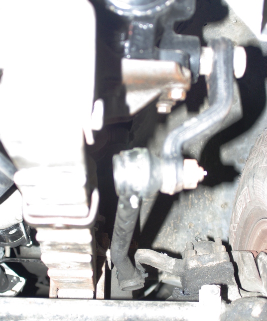

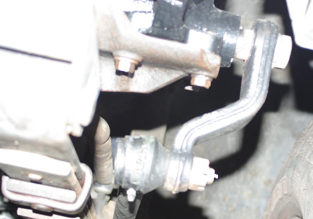

Thanks for the Pitman arm. I guess I wouldn't have done it without you finding me one...
Btw,
How close does your pitman put your draglink to your spring pack ? 1/2" - 3/4"
Couldn't get the draglink in without removing the pitman. You ?
EDIT:
Bob's draglink picture attached.

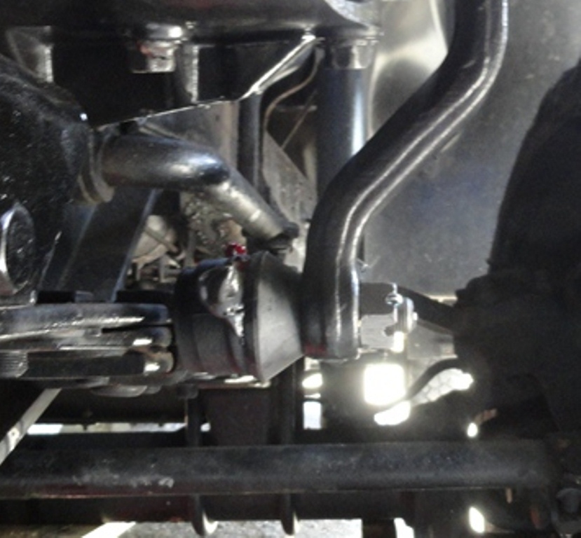

Old Mar 26, 2012 | 10:35 PM
PapeCAT's Avatar
Posts: 2,658
Likes: 85
Mine
I have to turn the wheel all the way to full right turn to get the DL off. Haven't needed to remove the pitman.
Here is another pic (guy has a lift):
revstockparm.jpg?t=1323017638
