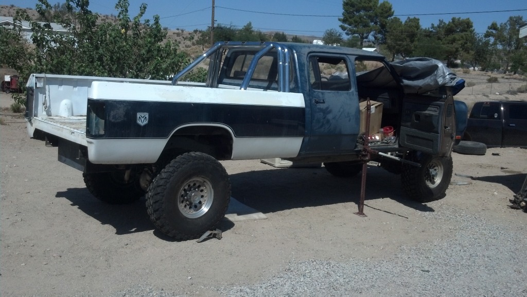

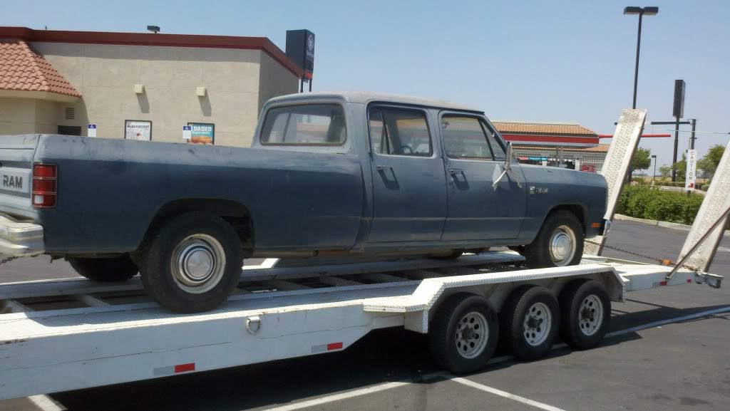

Old Oct 8, 2012 | 02:47 PM
simplysmn's Avatar
Posts: 2,273
From: Apple Valley Ca.
Size:  77.5 KBthis is what I started with
Size:  188.0 KB this was a couple week's ago
this was yesterday
