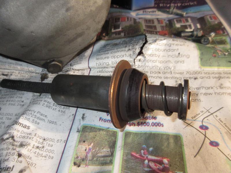

The plunger was getting sticky.

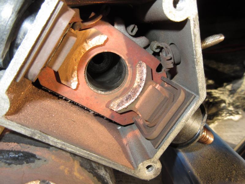

I probably could have got by with just cleaning, grease and replace the contacts but..

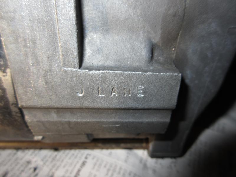

My truck license number is also on the starter.

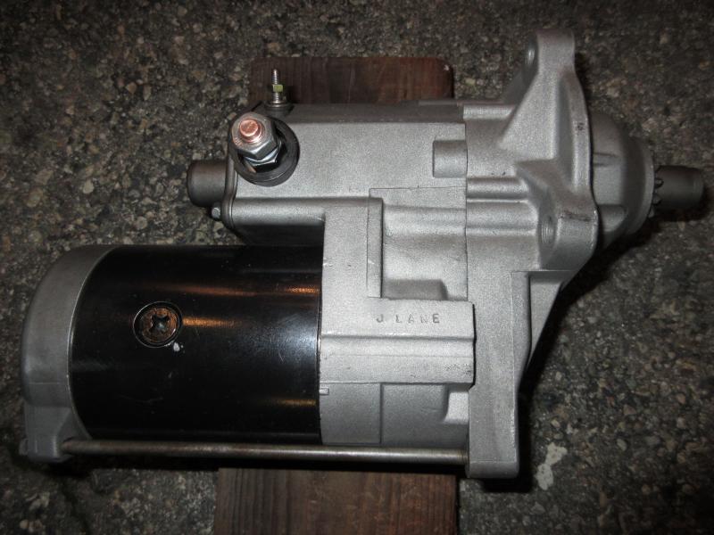

Ready to be installed.

The only possible indication that it was failing was for the last few days the starter did not feel as strong as it usually is but I passed that off as my battery being a bit low because of my new dash cam that is always on.
Tonight after dinner I installed the starter and reconnected all of the cables, the truck is back to starting well within the first revolution.

Did you make sure to show him the markings on the starter....or did he figure that out himself.
With the cost of new starters, and their somewhat suspect reliability, you are way better off having your OEM unit serviced and repaired.
Not really sure if he ever figured it out or not, but I like to mark things that are mine, like if it ever got stolen I could identify it so many different ways, kind of like a Porsche with the matching serial number on the cigarette lighter.
