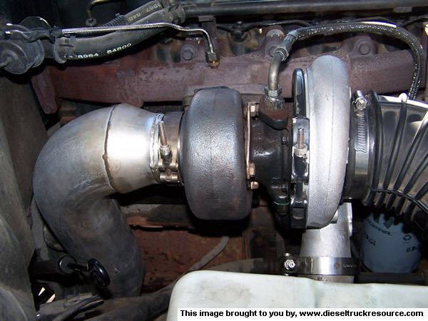

Here's a pic of my Stan's DP:
I think there is a little more room between the heater box and the DP than what the pic shows. I haven't messed with the insulation there yet, so I'm not sure how much more room you have behind it (if you were to trim it). Notice how there is no straight piece between the housing flange and the 90* bend? I am almost positive it would fit...guess I'll know soon.
Old Jul 31, 2006 | 05:32 PM
wannadiesel's Avatar
Posts: 22,594
From: New Holland, PA
If you add a heat shield like is on the stock DP, you can put it right up against the heater box insulation. Mine's been there 3 years and nothing's melted.
Old Jul 31, 2006 | 05:37 PM
jrussell's Avatar
Posts: 3,660
From: Florida
Good to know!
I've still got the stock DP and can just cut the heat shield off that and tack it on.
