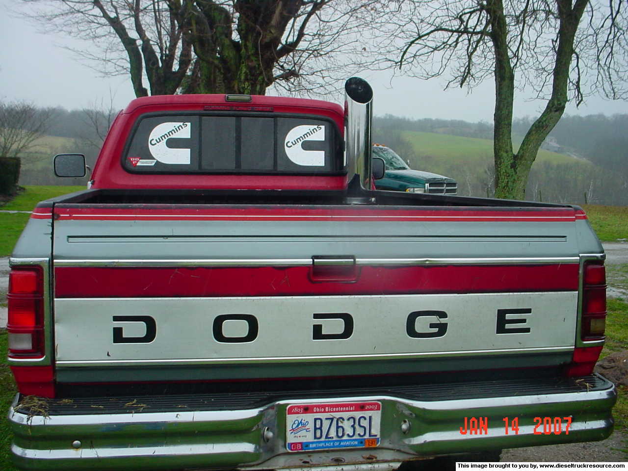

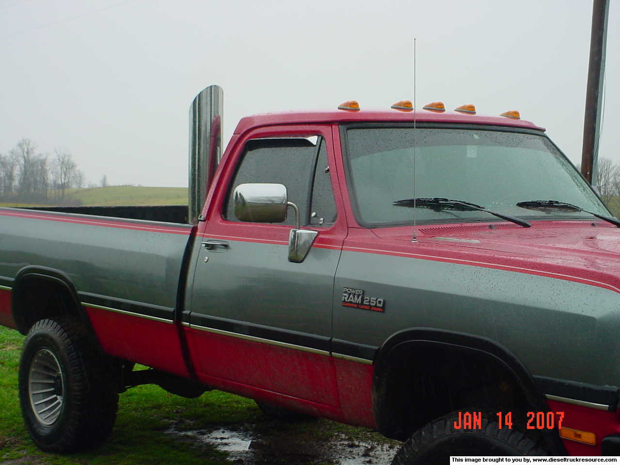

Finally got some picks up of my truck. They are in my Gallery. Would post them in the thread but cant seem to figure it out. Plus theres too many.

That's great but where is the smoke?

Now that's a STACK. With that pipe on there you can burn wood if you want to make smoke!!

That thing is insane!!!!
Not really a big stack fan, but that looks good.
Really nice truck, by the way.

Dont worry, she smokes. I hope to have a couple video's for you all as soon as it dry's up around here. Cant do much on a wet road. Thanks for the compliments.

Newbie question - What happens when it rains? Where does it go?

Goes down the hole. Spews black rain when you start it. Most guys drill a small drain hole at the low point of the system.
On my truck, 4" pipe runs up inside the 5" stack until about 6" from the end. Most of the water runs down the walls of the 5" (it rarely rains straight down) and drains through holes drilled in the adapter. My truck stays fairly clean as a result.

That thing is effin HUGE Looks Great!!!

Yea ive got about a 3/16 hole in the lowest point of the exhaust. Its been raining here for the last 3 days and the truck is still sootless.

Dang, that is HUGE!! Where'd you get those Cummins stickers on the back window?

Rick, you know as good as anyone else that stack pictures are no good unless you have smokey stack pictures.
That stack is acceptable as long as you can roll the coals out of it. If those special EDM's don't make enough smoke to fill that stack, then it's of questionable taste.

These special edm's make enough smoke to fill two 7in stacks and prolly then some. The ddp 3's make enough smoke until the sps62 lights then its just a lil haze. Ill get some smokey picks for you all as soon as I can, since there seems to be a request for a few.
