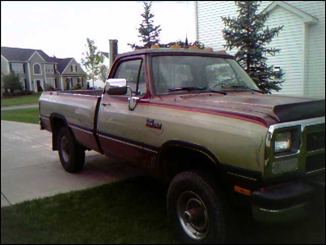

well guys this past weekend i came back to my hometown from college to put on my stack, it was harder than i thought, only because all my tools are at school
heres some pics
it is a little higher than i wanted but ill cut it down during class one of these days

I had a rain cap on a 4" stack first on my 92'. The tink tink tink got really old really quick. good luck with yours, hope you have better luck than i did. My bro in law just put a 5" stack with raincap on his 01' duramax 1 ton. He put a chunk of steel about 1/2 in thick and 1 1/2 by 2 inches on the end of the raincap that is on the other side of the pivot point. i really helped the rattling and keeps the cap from bouncing and keeps it steady. Have fun and enjoy it!

Most rain caps I have seen have a counterweight with a hole it that one could add a bolt and some washers to fine tune to opening of it.

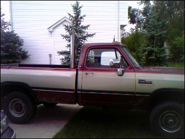

i will take some pics for you tomorrow, i kept the exhaust in the same place and ran 3 elbow pipes to get it over to the corner of the bed, underneath does not look to pretty but in the bed it looks actually pretty clean.

heres how i chose to install it, i don't think it looks to bad in terms of the piping inside the bed. take a look for yourself
and no its not held up by that wire, that was there to support it so i could tack the welds for the upper pipe and i guess i forgot to take it off haha
