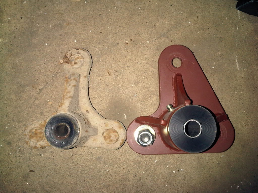

either that, or contact Jungle and get his bushing upsize kit. Got to cut a hole in the frame if you do his upgrade, though. That was the only thing that stopped me from buying it.
Old Mar 13, 2014 | 09:54 AM
BILTIT's Avatar
Joined: Nov 2010
Posts: 2,205
From: Lloydminster SK/AB

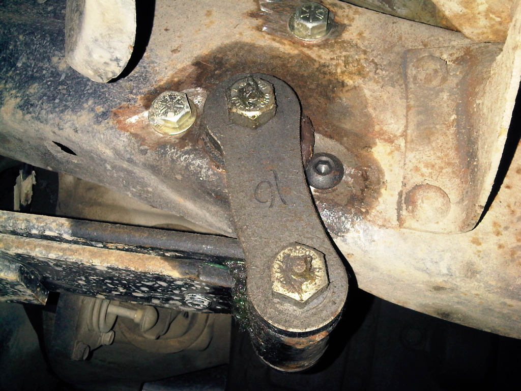

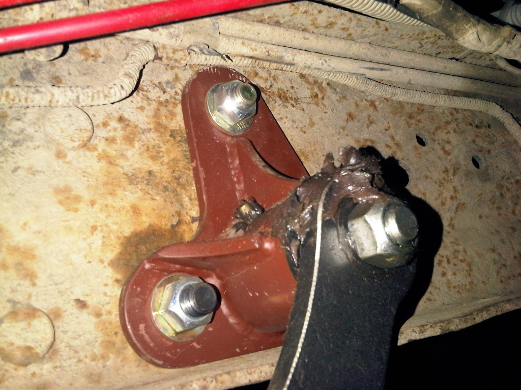

Cutting the hole in jungle kit was easy. I think easier than getting the factory bushing out.
The rear spring rear shackle bushing is a tough one to replace aswell, had to have a poly bushing machined down to fit. Jungle can get you any bushing size you want greasable or not. The upsize on the bolts is a good idea as i had to cut a few of the old ones out.
I went all greasable bushings which worked well for a year but then they start plugging up. The push in zerks in the bolts are no good, they push out eventually, thread in are the only way to go.
