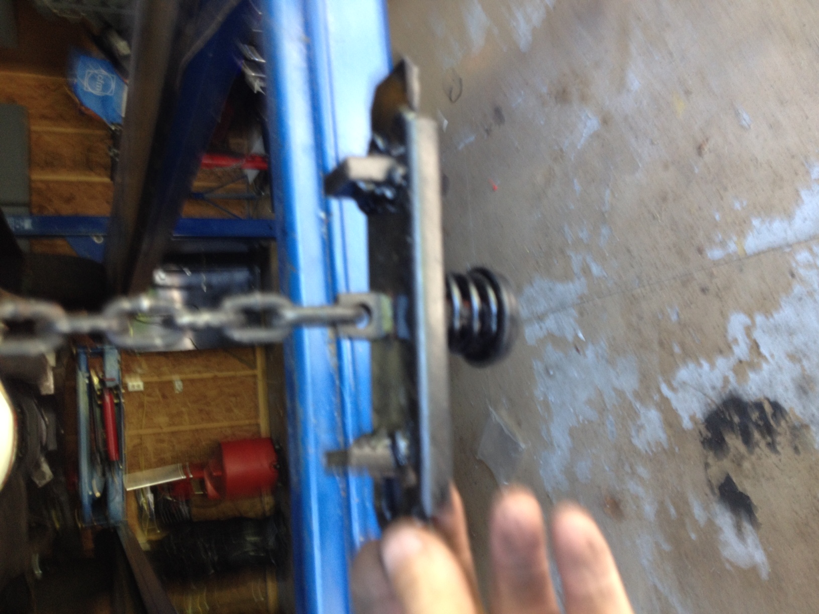

I think everyone realizes what a pain the factory spare tire holder is to work with,ugh. Well after installing a new hitch, mine would no longer fit.., so I decided to upgrade the whole mess. the first step was to find a suitable replacement. I chose a mid 80's Nissan.It seemed more heavy duty with the chain. I know there are lots of cable options , but I opted for the chain.

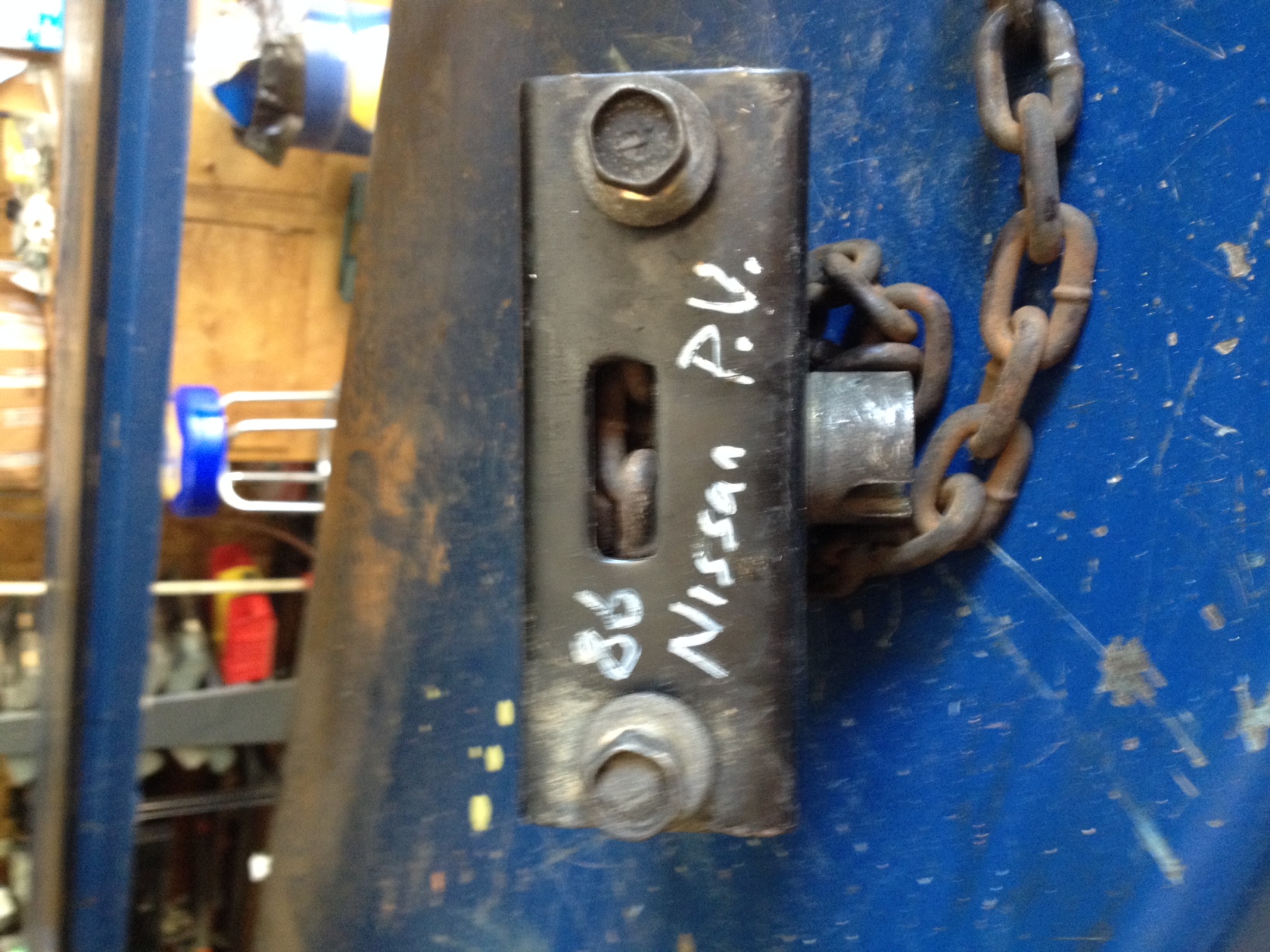

2nd step was I notched the existing cross bar to give room to bolt it up, I was able to use one factory hole, just needed to add one more

3rd step was to bolt the tire winch\holder up to cross bar. I also found a donor socket to fit the hole and welded it in (not pictured), to facilitate access for winch handle

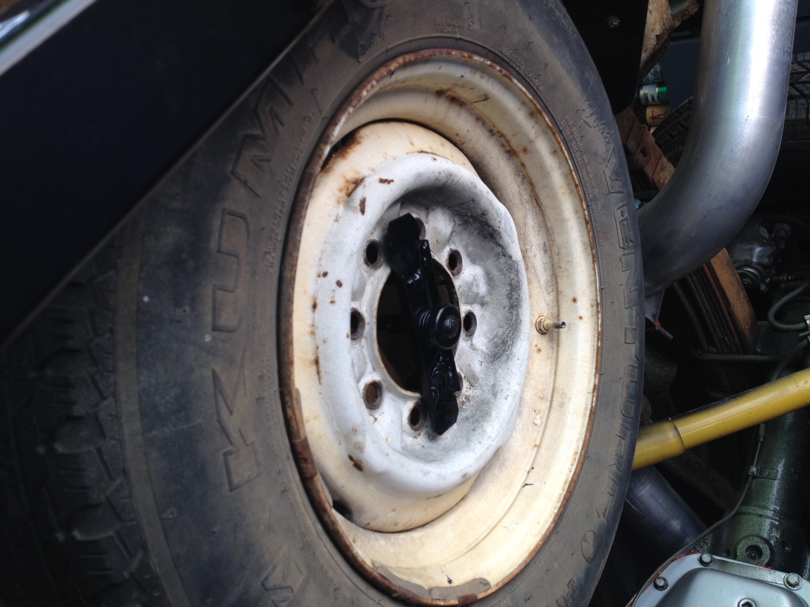

next I had to add a little metal to the ends and the tabs, of the bottom rim holder (so it wouldn't pull thru) due to our 16 inch tires vs. 15 inch Nissan tires

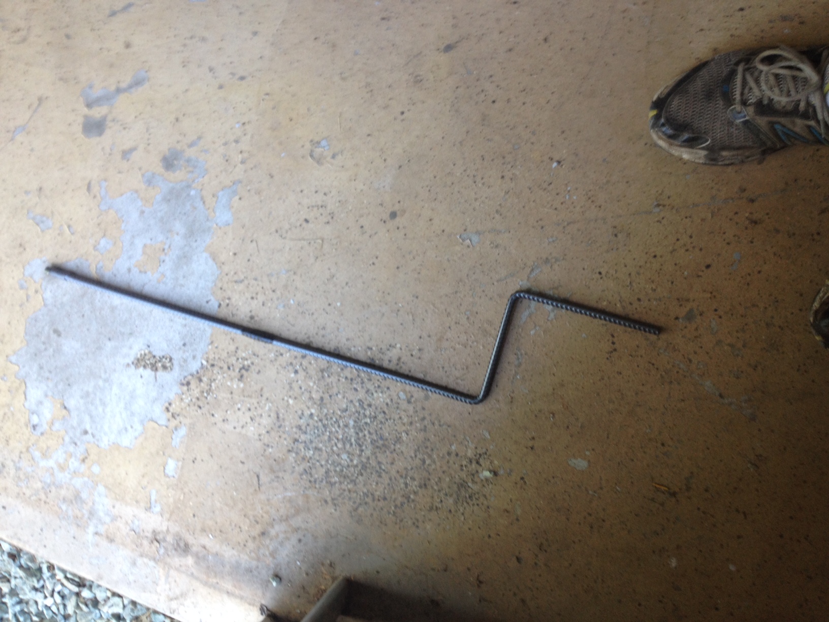

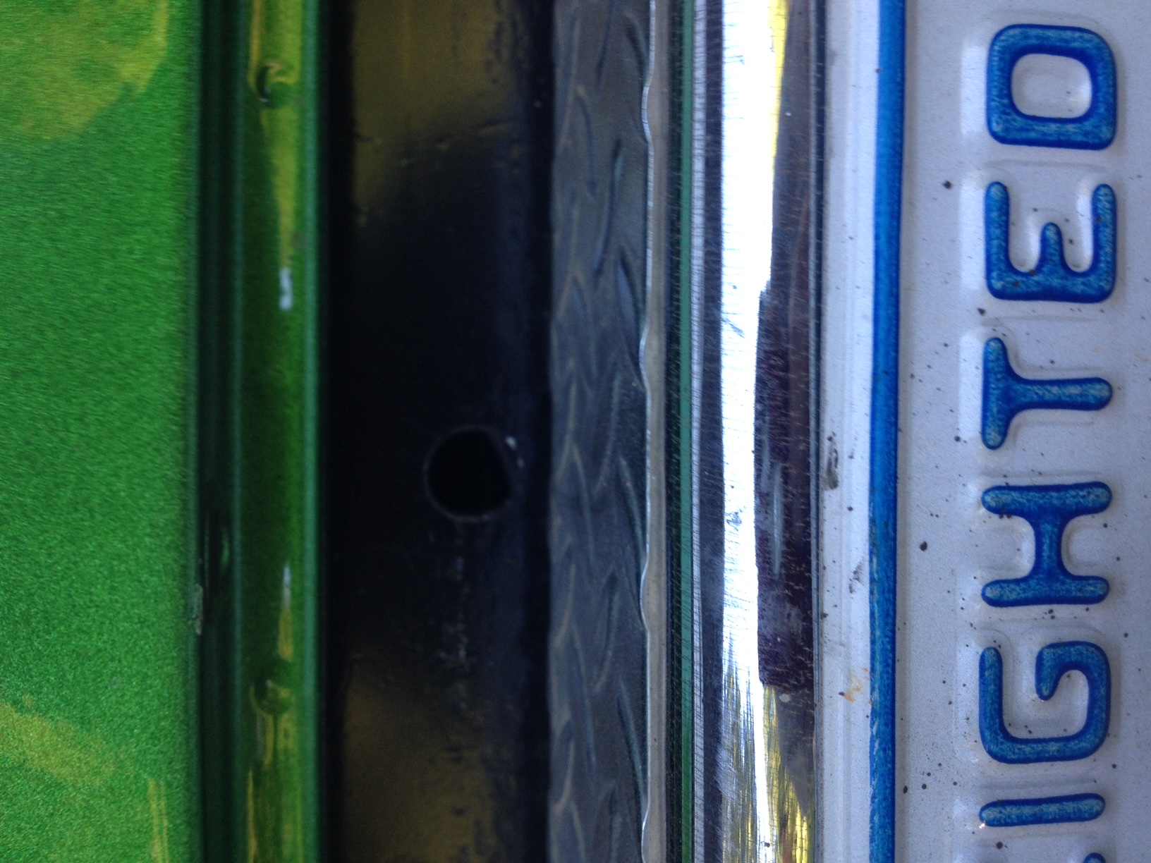

next I had to add one hole above license plate to access tire winch. then I proceeded to fab a winch handle,that fits into the welded in donor socket to activate tire winch..... and of course paint handle
Attached Thumbnails spare tire holder-img_2436.jpg   spare tire holder-img_2437.jpg

works great, and you can do it unassisted , sorry for all the sideways pictures...I have no clue how to fix that
