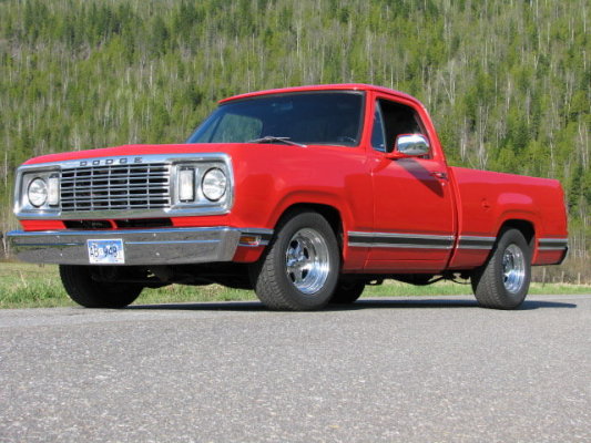

guys check out www.b-quiet.com in my opinion as good as dynamat and 1/3 the price. i have it my 78 with a big block/headers and 3" exhaust and its pretty quiet (inside). i used the b-quite ultimate on the floors, back wall and firewall and then used b-quiet "v-comp" on the floors and firewall. going to do a bit more v-comp on the floors and back wall. i have a full headliner in it from a 93 that i am going to pull out and do the roof with ultimate when i get the time.
